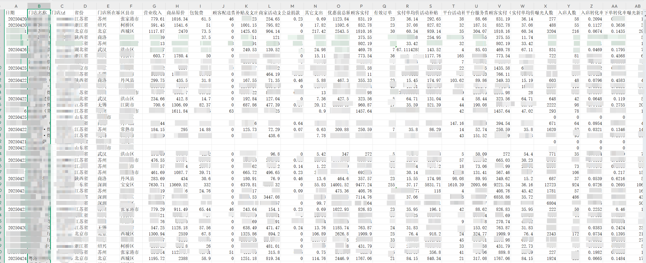

需求背景
当我们的表格列比较少,或者非常固定的情况下我们可以直接使用列索引去读取或者写入到指定列或行,比如图1的情况,但是如果当列非常多或者有时候可能不确定会不会修改列的时候,比如说图2这种情况,如果还是通过列名去读写改的话可靠性就会降低,所以这种情况下通过字典读写改会更可靠
如果用字典的话只需要保证字段名(列名)不变,位置可以随意修改,并且也可以额外任意位置新增列,会更方便,包含读取之后循环也可以直接通过键的方式取到值

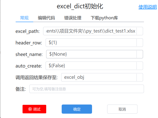

excel_dict初始化
9287568986cad3f1507156107b2dfc2dccb5e3ebf58a5df8b8043bd220f82170104cd438b6b54f49aa9f95808519690b3de3ac9ccac4ad2241244f31dd5e27ecb752087be7754bcb1622eb7ec2e122b1ff53c6e46156afec6177d11220f9546d32cf2c877ae2b5c5131ec41884e1659936f969e4df20d0400eb7c4986b4343c2b4024e878ac103a81fb9e721015483ed2e7c44e746ee552ca470d5aa959af350342a6b3e896db204c6c7e862d911abf075e56f63dbc3dd412f76a51f6e5e7fda1682cac8263ec77e42d5cfd3b7a95d4b04992cdbad5df48027b127e16dd874061fdec4432eab47afc1ecafea8fb116b8978ca64db649daaa5a1cfdb021b76691adbb5b7d05450255428ab510c53c1d867dd230a95719e565b0414d643770bc193a6829aa38dedc8f3a3432c3f84b23c6d8b36cfccdd27c0c861924c6eaac96218492420edcca4f0498cf6b173e31f1b8ad24a0fd98262f14405b8d8111509e889cf45684094bca1712f497db2151c71e5d08738f171ccc693cb1a5d59f9ebd9c4a15ce4d21bb1c65402397c99aa49a0015c7a37376dcc240508f1fd14d0897592aacb30f757bfe3814bc09c7f6b51992e1639eb2fab0a5a8fc33dffd992a1cdb9edb9b9f76e3f306fee30abe8e5de1561c6ca9d902c24dc51b9de9dbccefb94eb65754cc8a30c98b4e00bf76e42b94198266bd0bf56b9fe9d99bcd2e5921dfa98ff665f90526b471c28928ebb90b7bc714d9bbc0a75496699e6c3452e279c2a7ea4b065e6b0841db82ddf081b1ef46c26734108e376bdc9a57f4d1d696672d980b06002f93c38177be084e7a752fe46e4c5fb81e5608acd2df76c9f42254d4e86d20110c9372cc133c89679c9e3da2080705d03cc65b1207a9a6de6fe64fe6eca2222204e3d807835c619b2adddfb75194a018803866ee4f755b69302266b381309c0d88a24fef46c4f681ff571ebe2ddf9a3f399c7b5a810c761525c75deed9ebb7c9a936dc09e9559db337ecf8cbb68f632c3fba0e45fa470af41fc4ad59cefabfc3b37d3bfd07be1a2dbbe23a9236ea37fa6e5463c4d646bc67bb4982ad86902e1f61e0d7acf945f2d728e57b68d20e934fb8bafda5b8d2d75f8bf5ced3e73edc07f4c2a9094d46f2d8af263f02ea05b0b5ac624c621d140d62a689ec1fd494265e2a3ff034f6efc2d49ad9e218f200502cc24169a7b9fc62cbaa48ef5a567cf9de7b9c4e7b28138c939f05c0c8a5dfa058d459863afbcecb621926ddd44fda616e2bb0cdd82a353f07a0d6a761ca5ef6ff0c047f32fd8155c63fa1fd7639460beb583b404547f88b82bcbbf2edf3a1e74c0e82d70dc161a3aad891aa5bd05249b8c88188dc78ce4131f4d9c9631e819c0f8a98b5c9acf2b1252c57ee61fff733d7e7ff9b6167f4b69957c7b16556c6250a1b1e0c40e26354207befb12eaaf7c061b787fc226a23cbcc828dbb0f02037c51472978c83623762ecd9096f5ef2b4c2eea3556fbac0de7ede7f445b75627976b8da0603cea729822ca75be1a80d5261bd69315b40e2a6b65b29ab549902e8de5977daa890f2c4acd0710916b55a3bbcb402db6f250ac695980fbb9e7621360bee66b681b6e092eeff72cc32b1a20e5b139f676d45ffa10f8329dc6c7ae222f180c009609b90e9b4c5b5a01c371cf4926e20ecc6de1f782fd79489ea35b70b45cf0e5967ed447271cd72441f62d9985de9596deb67a7d0bd5a5a8bfc8fb1134c783d254312fc34bebb42ab1015d4f7fb864ae871bffa1d2ba75a7947ff3f8c06c018ad62cb6534a8704e7126872fd5c724a6a09c9aa6479ec63bfead430fd751a541f6ba3db660453b80e07bcc52b12a727e37b41e5a31ce58285a7c82265f01dd66c6bd2e06333e9c0b998e3bac1fce5f808f0c9ca199027631cf741477fe48a62f9e3bc2d1aa84f910a9407a38b9472b4e20bd2acfe752bd356940432db5a3a5010a2b32f1b83b81ae18eaf5fdc6dd5d03c15edf1a1534f1e4ac068ab536dd4dc1be86875a9162f61d29461f1fe1e4f78c8aca824743c13920f7c8bf8a407d63c4899168feb9128e0777c14ebf897125d58716472ef02af5f34458855dd08b1a2231db9184a7dc2865567c56438982ef755b716b80bf180c87d05cb33a1773f77f1a081c108f5e6dc268de22162817ad499d35d1d2234226352134211d5d0e72082378745563ce5be0da82bf578317ddacb791170e74444766d30bcfc806398eb183fa023a3226923af9cff1f67b0798183bd958a2099778f13e86b5691dfc3d1642228591ecccfb4f8eb11eba56079a6f04d6f065d96c7e06acf93c94c37ed0d5f56894f33964a33b2335a217ed2e5a84c6e1cd13443c2b11f4f2723dbd9f84b1df941c591c16db546261aa676222a0d2a003df421b29fed6288529e1a8a457fc90203b8e11f5af39890c7c694bf0ffeec88cded87e40bd69745ebcf20815e7c968cf6b31541bb12fad27464ecc8ab5111aa8cfe22a74675407211ccf3b37328336d4d238ff0dc1fd8b13a00f5a2a3dcb2162f30490cafc05414fe2c765d9f2157ef3aa4ebbc066547978ba63b43bc02a34747100a511394784bdde6e3b4b1410e948e4bead95e66be022db41206ee46d1c267e6611f97ab7d2d1c0781105d8fca4c3a58d8fe1465ccef4101b5e8010a2cb90ae7f1611fba2a13a146b8ee5521a54e02c4911ab1537b090749aa55e2de55160fbe1823c85083139765888ca2cec3b05b68be4e927f60f59e285e2ab5d5a7a5cfe37d80b1704834e253c5599c664929d324558cc59a11530f33d0ad57b8b8abd7f16665886bc1d2137167ae1fd5e09988bbbd3092ffb8535cc1a463e3e95a05fff9e5b95bc776b59e548815d17b910effc66c7da8d739b34f437b8cfd4cadd9bc94dc7372a814a1e5fd34344622ab854714b6c1df628bf9d84d586900360851ec50f9e181a75a6e86af26ef285b1d9b11b7ba7df04c7eae602e476f2af7b085a9dcdc053007674fe0d7f8808c16dbbf35c8b262ad02b3390d4ce360eb7c9204779d3d828e2ca53169620e84f91cee8d409d329d0eb1f9e5ea1ca5c6b9fc646bf22160d99d71b816e14b09419bbe5916d6267b79010723f82582010197e4d0244e1d52ce536a107c77b155c662afe7f82a81559ed862600e3af097a05d8d5e1eef0c0637fa34087e08acddc4f3f5ce209b9a4a8033e96fcb5df1e0abe382bd39c0f295e73426e6405107a40a927456b6356bf83958734f6f8769a31424b25d8c6101dd7bdc5f7ca5e80ee51caae3bb5ba80e9ce8f34a4fd9cdff270dd0c5239a2721ab7f60c7269c9b9a8f10623c20bcd0a7622c10e33702db376dd3da9e1c63466ff44c0e14ca9c12758d403252e8527135748bcdc2d7725dd40072066baee4d4681ce7431665c57c9b20100f7f1727db2908688c7178eb9a07605f94197629368a69adfd240ca038cf11e6650d57989d26c17396e855fcea1f5ec53e06a69c3df962bb7bb201e3ad6e1d508706aecfd5c58b197e80ab46b32f82bdb051ed71b6ff61dbb5b6476eebc4859153d623ecbfedf230d161885e08bdd71f963593d38b4231c24216944dea9fdb59d418b485ec5f26505143b52f13697fe7026f5cfd1b1afb8cceda9e77a7a2eace8406b02ae865d36cca9a6ec2a5161e9a399a74d5e81a9b1fef935a0b20088e8d77104a5c89ff7bbe69fb25bf77b9deafe1de07f7ea2b074b809094b3aebdb14de0ca9a2de8d0171554451af4efa2821b2bed894bdec14a794eb61aa3511532ba1a28b6af022caa636f619815188c99d19d43fd8301c5048a3c811fbc6586741a768ff1471a39230b6603efb0e7aa8897688abcbeff480060a72097b9307f6479c3dc1a707124288bbf16ca4fa357a20356672b0f1805ed50494531eeba116d6455c285f58ffd721bee6e04ad183a887a99c71acbdac148fea7fb6103c6b4528d1ee0acdfc9224a75c7d75dd4f4fd0403c0e75767a86feb05dda79a59b4708a6b5794af7671728fbc9a500114786188f6fc8baf1af2b9e7d3451731fa04298ec676e9c78c62f2761a558add61fbe836a8edf3548e1477cbf4fc28662241017cc666ebb737723c0ed5ec9bcd45b9ab2f6812563f3c0aa6dafe6d2b4cb09cf7639a255f351fbc9d20236ece50fa45641ed11df493f344c7abd88db35f09df57026445a3a86413ba37a3b82c9f1be3f14becc821ee036cc549ab1c632b294fefcb015d603f8780b401e12cc859979f5d35608c3fedd5cc9e2b8b5eeb56cd8d038258526a5386222ff03472979cec7d350581fb8fffaa50b0523c6a817c85203a8f1e7658caf7f6ebe9eb28220c69718bf2d3d1bef4e6c80ab32dd0d91f9127699381b61d53ebba000d834eb7a724cbd286278f9fd01c75dfcc8a52e309a79be7b9a26185ed9cdb8c114e52c923b6e3366e33aca2e0517cc9382d4143b753418706a9b66708ceb8830e4fbfe49cef6c91a39c644dabfa167d63d5474bb00fe4d3755ed10a1d395f44486d41370b09af77a1f18a19b7303b65866f78a313bb24dea123ba9e4421b5d031849ad7e61014c54035359d3a07c13ccb9593c99245623e655df58b740afee807082bf2c016ec7c0cc1548f3867663fbe9b8047542d6dc31507a74ef1b890742afd4631f6c0bd134e87779ab13cca9062fa259ebd9c60840fd4b9ba26f6aaba07bab0cb15a0cb20600e79cbf392073f1df1fad750815430c04392a8ce1b2cb07079a6884736320c09bff866dffacb50d0ac86164f302e486e0dd684095ab1cba5ac6205628b0131f4dfe0134a2dc77afb84918f659dade11c30c2749380ba99bb62baccd156111d715fcc5f506caf268f3def48734122b29f4aeb3a39c5a736c9f147135fd38bf6d3ea275cb0c97388554f2037ce41393219be4668842c42f970303f4f7f960ffea96f19a1daf073470250eefaf45da7045176a38cdc15742e82a1b87d32acd20d305b80c7fc9b7d130e9b78406b88015cf36a93ea13997409fa892f356620c9820a1fff26cd495ebd79541608ee758e084bc3cc54640c7e93cee35ed26a77ed3cefc618ffaa613deae9bcad9f00a23e0a7f121f70ff19da88580af2d0ac057e4598ad2cbf4ab152765cd68bbcf086b58ad59b06f9dda7695947284b51d38f698eceba6bee35df35dde61f4438ccdd5a387cef9573649dbb243796160734a6c2993168b4610f283c826e898fef03991288867f3a3469c342260d7bd921f97b83734b230658779222e77536e534e7cd52d3531579c5d440d2bae8013fcc235e46f6de05cfc633b80f5a9fb81a10a7b860b9c40d9602bf2fb9515a13608e4a8deff934f835f8ada2766022eb79eaa895c2300ef5bf42103138d00281f94bb6e46c11917bc0bf161e24e3a74d495da2149b6d5f3c1586e118a63529e6e6ded29e67340f82c4a8b25cde3104bfa7d6479f192cc468df86eceed21a8ad1748688818bd9b5771decd434a88c5047ad5191a002e4f87f52b870c20a3b800c07515204ae4c6e59260f2bdfe9fd6af409513716978b94e7345c1233c8f079485bbfaf06965561c77087c3b54713eca3d9892dd147f592a182256072e7ce31cd9d9db9feee4eabcf6e28399724d6114f716d9c16e3cf54f464ee18be34c3ddb9dce98d005588b6ce0ea85cde59c738c0387cc856dea9a3ce33cdc29b97479decfe93349a73d5cbd1eded991854b9a88d4163ac1ad33162b003c0c81abdf8c215ace141c9f67c6817086a60f165ec7f5d1bbc3d7c9814670f77f428ff6b1127ddece4bacad6518b75ca244ac48fa584cb5d025b404c71433a4bcace36afcb8c8147f99d6213931db29d1044326a5152a54f28902d7963f466c0edb3a1a03fe4c90b083f04e756aa47ceb569b96325c4f1c8f999f8c61e6b3abdbfde1ea9ed542bbf22e075131cb570b248568fb8d0de5d6f40a0d293fe17664aba64ce5672eb24abba246c9b4ea011df10ea4deebc91d0077e7c0d78f44668930f9c5617ab6e815bdad4ddd691861acf65295ca23729fdeff89736de823b2e5c9183817b86a612ce26dd96e0066cf2941f769564503d3d1b4857f8e5c1bea286d65fab5ddc951597f57b2ef2a4396f9e3775810ebda41baef8267baaab27b164f0c746482cd83752ee113c22d9a99d1a785b41a6a2ce7b2b4a2d6e28211c0f13a18a01f6ef73a43c1d0ba4c4cabb66e2f68228bc606648172f33774efad8a372db37f94a312f592444750cf7cc2456f673b3db470bd9676461f283111b09e93811bef29b1afc8e18010339659385cc049c0b2b2eb2d78d0878850b5349168938df1891d5a0688d65445e0a2cdabed6ad3aca687cda826874ffce124ed337739e7f3dc56f2dda9cd3bdadb7cc42f5d402321bdd387839f88bed59fb2ee625db75e3fe28b669e38835a5be3c2fc3e2a55bf39f0dcf57366069151a1c6f80da43529d98e91a14c7f9c9aec41b53828d335d9f4d64b3235937de0f991c0b3df09113ded39a23a91b2e204ebc36cff2686809db035a8aa272aa655453a1a9f881d92495658e7a39ef8723d2e2fbbc99ed4f19e2fb4a4cc03e65566228c3d6dafe3db64e8a032f65329c2ec72c2a8eac38ed1e6f06967fef9cdf01bdd6a4134cdf2ad4b2f6c1433c55a54c094171f102cf3a41ef4f5e77c76c35ec483dd642a1c5ea7fd318872c5abc3f9116bcc85708f59672a67d0889759f8bfd397c2d6f0eff4877d5c15a616416bdf20d17d705cb31b3ef693263395f350df64233946479734d9cd7b20e82df3632d41ece5c14dd5f9c32a052592f32c5270edfdf8553c519bccbb7f2057314a8c84c3d6a511273feb4e639ea62319f1ea966fc8c1cff96338fc239bc00d489c5aef121e6d28741ad5b4af98868df336e242703735db05cc870e639fb9c4bfb3379d288f0816f6ea1dba74306a2f584f97782a8d2168566ca5e1bff438c089d073b541e3d400a132d043c921616295e75bb7332f2e0a31a7e4c63adfa9c91b05db4fbb0957ae1771e5abb105bbcab545627b7e63c9fcc688636f40cc994d6f09ceaf4fd33993c309e22f2c7100c7a2ca7a1ed052abc67df7bc979ff4a426375603f6e4cb60423a25c60f87bef2450f4bcca02c4caeccd110abc66cc3c41e021bd714b5467db1d4c8657f75226269b7c0ee8f61f7d3c60147acd743da7eea66fe4b279534652e02142b27a5da95a75d505a0e79f5d7c308d198aacec25c8d74f29fcee9f4c926a4d5078ba1dcfedf0f6158dcf93e914e9a64e1edbf2eadf72a687a17e8cced8bcb7d9118b4e3ddc2bc3aab0ef56352626cefbbf04205196df6c31276a24ba0c5cf15f9e7f636eeccb1ff6d57b415ceba60286424470e94baae156e40857c131e9dd78805f5f22e9a81c37dccbc0d65b19228f44393c676d5f384e44560894975959ecd6c036299b11b2926a36bc2401c0f051b43f2624b3beed9dff3d75ea6c70cd87d173aa7e6bacec79bf5f3b522b544938f36e6d4a022e5ace208b5d418816407ce5ead737f97bc1bc2f13471d780bf4102f9bf77a7fe8a1af6482bfc38ea5d0c823dee7908b9d0017409ada4667834ea29bfe1b484543e16c77cf84b294dd3dd5f4f91f0eb1f53d5b8c9b217e9174b198fec875d1a59beb7637b3e63ca37f3cd8baec7b3457896c54c4d96af36308cd114e2f1aed986be53e1ef2e4fb7d3cc910c88eb2dfb5be49c3e76934d69d8b64fd8f0ef2f9a66c41499a049d4f730b3813043ec7e7ddd7cf903493121d13b1de763d661b76a0eb9d86a93cfbcb40a85fa6c162c9039ee118f74c18254ec93c7880e35bf64e4eb7f3116f47f91470dcdb015b38f5e7d146cf46f6b675494108c58dbd38f39377d8e12d6cb7e6128e7110430f02357d01d0485db6bb9b2c56abc3becad1a8bd674c1cbde7f78b1425876b6f2611521f8a1aa68b54b0f30b1dc57c7de769839fa03ab71139b421ec826f407ba24a67f02200ede6d399b47bd555874097842fc76190ef5652916ba63139171e72cd32ce06cf95929fc59e78cf319f54067e39ead87bb23efd494f3a13b1d8530d1f0780177921a4dcad49302391d7f5dbe7d4eeb729250408c35ed141cbddeacb812643388aa0183ef0aac57e37ade89f9170a0b5bcde7e392b520ea92666f91ec161c6ed00637b3838ffd0315a862f4581d1fe554f88cc93b8be92dd7188db6a3f2cced259c862cb605ebbcb05b1204ae04bcaf00f138814424caddf19a270509bfd9c8fd06d36eec09ba4c3d4544a23ce16f54d33855c58aa00131e2f6e7196315d69f8abb6ca15e06679f8f24806e75dc010d8732b0ab64318d60f3b6135ae1d29b409cc76d635c28f5859c95a3596636d5c7d3d987bd3b715a4443aea168808eb6765e53d31a5c127437c4e40c69b068f657cd5f68c6f3ccec6c54b6dcb5c1bf0bde063ef9dbc8bb877c42a578d2d5b5f81b16d17b5b6794c25c1abbd9a7a8f8ecd03a1c917a0a4b9c6b64b7b46e2fe9544f307a7316dccc0a384cd00fd2152d91d0f64a04f5655a55d5f4411c0797c5609c9efa2f57daf4424db0bb7ef27c38daafb803fa9ccce64f278825a848ab56013afb587121917a8ffb8cc9167f868588c8dc27066672650f51ee9e79066d015cb0cc66e360d4dd132d91bb1436826d3aa1380086b4b7f91bb93f31f78c12f4a19e333f39a7c4d9b7223e2f32947c8088cf578518c507d191cb22d49d1cac2289eafbbc1341422e8c65013fdc1f03dac8accde054c1ad80c1d7e2ce8b6ef05ff02bfedcc6196be8ca2f94bcb76e6e81a721a9ffac985c416196803e52f730dbfea6f2aae2a81889b3be3a5dde83a8cef15615fff657c31ef7c12d10c333ab7adb033dd33d548828df6f1d6a61807cfb2a087636145d8d17d0f8f4564edf6a5c5c24ab8e7eab911fd41ab81513a774558bcec57870d53ebabc48bba37def2ab50de51fe9a9daf3c1e21f975e74d4fa22392a4bc2203df02aa6ed5a6d11632b0922b96ba8b0a56e3035d0b4f5c444f671e34cac58112a0976decb42e3fb6d2e983d3dbb4bb5c4d040431e2df22365519279cf691c693eca60370f97bc9a96f92403737c8b6fff49a46f1ef27aff12842cd6f24a816f0fe8c058deef77ba3568e76e89080d2c9487ee2263780bb4c1e248c0f72bb89c371469aec68eadb329aef1f2d32d4210f3704cf56a06670cfe52ea44c70885bd00848beebbae37eda44aebc133e4bc749d2e2b005706b27058867d8df3b9cc4106a0f8b411c6c181e51a9ce2a57f024ddcf09d526ad5635d8ee93879b328f2c2ba165ddbfc0b3fe7c03a26fa21817f6c77b0bac2a59c8cee2d8641f4f84f1e009f1f0caf7c0a5fd3df88e447ff4cde508c526cfb6cc0d6d908583f95d599ce4da36b213edf22646ef69bfbc56bede32c74f92d281d418413841a843376cc1cc45dfb902c8550c9f7851ebba368ead9ece452182d4e5121e3ed2f83f09118b0b3429dfe6a92045fd9f0771dadb2660a32b1057861b5256a5ad42bc13e0a106b395886c41e6fad9c991024d9992c74d67d29b189ec54c04f5e83d614572d65c12d8dee218ab173566faadc30f8a30167d2cb9d5b709b221813f38713d7bca47e3a19d8f903ec2644268a4ce38b2fd8440c1fb4c72739e90673c967533ebda8e7db6bb67fcdd0e98c774d2de462a9155800ebe2edfd1b2adb5f4c0c7bfe9b331bccd6836f72f689e0e7bb2758b885ab029a34f65c7d77f8e1d9fe7869d13e8947784d21365ec3d318d275f003d7d035568393e2798b875efe17accef365793bfdafcd30e20a33b030746816677b02caa1f7bc23d2d78a2cb04f1534261aaed626f465c881c6ff5c2416956cfc6369386abfabf82d0368a3ec9b8cc2fd1fc2d30e573fa6e898ad7d26624030cd0f40534fe79c19e78045602b9f6a711e68d595938ec942018055036c84ea49879a172dac9d429981da047d7c400bf99c9763ee25ab923f12249da47ffac42971e66c55ec55ff45f26547b009b017bd01f552db31caff60ec3932e566409a6865a7eaa30e5b06864f544a0185c48ff62aeec3ec7c90f113a1ff9f7db6e06107064cd89c5ef60f78edfeb1a344ab3c1e9d47434c998465ef5733778f7ccfa712acaf725ee82152d2cae9b9f9c8cd6f1b0a89dff91870726d2682efec0c96e8ff861ac50c9e942f91f137d2592c1000a2ca55e1b64787c33d955a2d231d775dccb10460feb550533b07cd19ec4bbfc844fb351a9967b812d2c94ca0b76c78351d501fdd18ceb8791732d1bfa6b507e3a45d632b727775305c9a53916fa6fbfb813c20955377c1f610fd9c35a67d94aec9671e011d814ffadc468a1eb3d231d2ba7b53fdcd2d6b47e2773bfde6d9581c89f0bcec71debb90e65ae7998b9c644deb85daff14028add764331f37a6fcd80cfbefaff657d9caf0d0da543be497666f5e5bd8ecddcb6f8e5fe6e1f4976903616c431658582b5b5dc7f0b0b2338bbeb2fe6fee9fe9cf3ebcc07d94fb80d72327d00bcaf9e4a9647d8abbce38324aaab160368798974a0f6bbdfb5452769213a9bf5b5b177d606a5081049ec0421775c4c0022ff7e57b9ed8237b04a1cc6a99b6b46894019f1b4e23ece877709feb3dba1e8acf062ee74d6405fa12b92e936878c8d20e34bd12127ff1de2f630f1051ef93668ba44bd338a4c259a7e0663468ae376f612397d5c5fc4f67597427a74ec28313ca1b20ce7ff2988a392840d7225e46738e7d842eb49778940908e133b748d26816387916aa03fd6b634bc588d8e49274d571e2b4aa022237661fd966500b62271b4111cb88e5ab24fa3c4b70c3f9f6b3dfb5719ec7d9507225e9da5b906161c85967b3fb92589d5671c9add3b31d34e31f34a4e30f71fe9f1b1d11ee57e43b44859b939a135cf63b1d3cd11b18ea6340dac8bcafc66a917b075db7cb6d6f1fd35d0dc4c5cfe90da7593c779add43bceb1a5943c92536436df6367b4e2ed71d0b6abe3af15ddf4dd358bf47d14002c48fdc8d3a65347d17dcc7cb9586659b9f27888279770bdf175dab81534f70c1d147814a3fc10a828a6f7addd2403291be3ae453a49f3e4b85dd243c3fcc6c43a9f404a53f8a3220c3f2f908ab8b9e0e994ef3002e513291e5271e1eb6fcd3827b2f2a163c63d93f3dc4b95c9b839bb49f74cb24251f5992a0753fce6c4b4a252afb1a80b9d3410c401831b3d62753b1f88099f119c9790c67838a59a4e423c51337a9bacac3d9c9878a3548df2a63b17ed9d96f3621ac69cfdf49d98c40010251daa6eab5fd7e843979b2bd33c89779c8c81e8ca33b5ced55c94cae84a298e60868db6fcd5c48ed05dfea2d66afbb8f3dc998cc890d0381dbe0e7f1ab76680ea29463b83969ddc7c78f913c811c3cbb41ef70c2db74e47cb4c7749a975f8a796fc47206ce50aa3b139893d8df03220aa1616096beba98c29404fc013fea6b8bfccf93babf157399df2e21ab6ef5f50ab0b40d1e901ba296da3d5d1ca62e5e4d308d439dacbb780444c66aa2c5a4c7bab76af330307320392932e60b016fd250c59b05712f97574de12c07d7ee0c7e0dd6e09c00606a08b14661c594ab871c1f5f8e523298ab4bf63b2df14e57b8ce90e35391740f5692f80c8fe7bf9860538dc3885304b34e687f3185f6e90d58ff3a6a9dae391636f3d91c6249ad69f81c49a92ca1e9631fc17580c7907d07bcb632f9f92b1248c87ec1d233bb38d97fa04ff6d99dc2ee3b183a67937b2153f2480183a9e8ec888f8b93443cde484f34009194611dfab6ce00711687dadaf5913ffc4b6b225fc9512ef526f9eecf9fa7b45a9bb6d427cc6384c60c5af3327c4b6ec20ed5f63d40cb92b89ada1b861fbe2f910f057baa6d1042b34ac4f65273d6dcac62f1c290e02fde3423116ac79ce33ed782b82e9655f4e92be9e15cfc1c2e9193457bbabf133b3e3a43bceeb7efb6eedea5b3dd904a205de134a2c06a215a485becb9be8cf62bb16fca321385adcd350e7d4590887a5b289ac76d68e36bf11f68332d8e5a07b340b400fdd342a81b89e490f9751cb89e15ff72b7602d72ee27082278b0a5cf1bea22309d6949063aa27491d2d753847971dcecf84b6bf7cc80869b91569ea14e4ce796cc0151d1bbfd4cdf5bb05bad2c6c2f963b79b0c51a74bb3af6a3717a78f70cb93b69782e769cd032daae8dba141bdda75fa05e8f141b516460a3f95dd837a37f615a129d0315264a1013ffadf6b3756f999c648fee20100bb2e078d4dd0de6e3d49d917a0fcde80130215eb2dfb1913440a2382ace46084c45271b5a23295e1b560e2370b93d4705102e77b882ff3a55025c44c0c5671a7be9323af6a07f645bf00eadbb7733fd7488758b9d7aa04900b34b2fb50ce7f2eccaeef5f6f6dc9da691437091f3ea106643b0a9786e5362af232c3cd9d7b35087b6faef966944ce9a01f2d06ce59e42dcfcb1f0490adaf6d61466696285171b520bd5ce49e5abbd6c49df84d1961e070f19b4d2df7b6d49d1e07cb631491ee95ab835abf9e434b91a9ed4484620ee6b5f34828af08dc5fad5352bd27ef8b3d9a00e9cbb6e3a2c2a9b8ee1bbcabc8e3fdb255f066eed98b2f10f3f2db22bb37e77e89af7415c57987431d39527999d705fa4ca0e6f290307ae180a63d4e69c9c1749ce4c47f60fbe4c17392ec2e9328102537842299f5f5c35a6f9c6f37c55a1e06c5852cbbd0424dae3403b586f35dd64f7c200e23af107dcb3de39650b7efedc510fb332c7e7fd3b0b6429dbff0b0a6e3f3cd2e9299cbc7cc2427b5fb16d2e2fc35a4cd8b773f06b82f524ee5a181858af902bad4d174c13ff3119e3380b2946cdaa98389d056734d3334b6c3765917dc7157a2a0483c673dd17fef1974cc47e17606a676fd1de5148408a398827a7368360e9959665bc42aa07fbe9cbe53cf347f49e21bee91eed518b0594900895450f4f3dfdb6765dd5d763506adc26a37af6105043a27e57d9f88abf79380d8f861c2f5f74f900d9a82f2d7b324ad380c6ce4a7b1360cdf34ad7da6d26c2bb9f7af1278bcab707019db64fd8793c824ba0fd98f84816f6270bb83655a66b3d8c574a961adb0da3ecd202aceff6b8be508fc77126162d338ad858020b7c50bb8e90791a3c5d1918a1661123c42736945a32eec14a6d767e9b687f66cf71e4486a28e3628f13d3e31a1d609ecd51ef2767bea5a0fcb7e6dab2e6a202b7bf039bf1edc09dafb18e3269c14d1b4c27c948faa194dcca7ca29b824f8eaaec40b229796dd9d9e660be225f0a0b6c38f1612d745c48f75193d1907f012cd3d9193db1ba327e32a50a8f60214df71d0848f7663a6b832de58d6c51ea93405407a7ed37c5e395b0bde99dc625f4dda54b0281916d8152baaefa2507dbaa6f6085eeaa87d359fa104ebd6051a849510436a9d123e31451c6da185303e6ee717b6c0bec51598d9a4b38336382a8bb5239b06654794180ddd3365548d0e9b21c97bc6ea13c60a379b73fa1df9208ab7fd95dbbd4f44acd35069a2a86066253a4f0ffc68dad9bf9ad3783c3747ade58ac86f4694e984f0bd0139e56e0f4987a2900eb755aae16638191aa3dc1118160f9d33161e0d247ce59b7c1e1380c984dc599919ca4e895dad13aaefe0e38199270290dbb8ba11b8e86a8060304f3f647585a1b0f62e3c5000c9ef61bf328c9804b9fc1f8979f71288b29c240a6ab389636b5fde05f4fa259a695a8a5881a926f014a85915d651af8a3810205b839134a73f2f11732551e4301bef3ab62d0eed4ffc25340c05ccfdb8a055b486bd77f3feef69ca4e41ee1d0fb2c789ba05363011742f62d9ed7b3dd4af4bdf0f157911d5e155f9c8cb51a3f6d749741f90133f92064b37ac8b272f032d4bd241c96fae07276ff2443cbe14c05f74af9b03affbc06ad5961c4b295549ee747882be9183443c936c5b00a519d6f9654c6ec34bf7dc92c66ec5f1fdaf8f405c698511543c3abd25821120cb4326da2eb81ef3392e0c124a923cd8375a40e2ca09c8e205969a1eda4a5d67b0479d70c4c9a8c96c6f59a56898d1e7a0660b80ed6aaa3f7d6fdc7ae5f84b9d51346bc8bb47647dd8660594cbc98d9a77771537ba83a95dc114f3a42eb56ed306c2e44baae51a035871efd50b7887425a44acda7f64a79bc696a632d4d9119755c5fae7b61ec347c77d138a4f3cce992eb7a738ba53f560e7ee4c1d1d10d25daceac5b4b6e44179b6a798b133b3bba7d1bc8fddd19cb2ebee51eaca63b768cff094e7f9c60d09480fe3abf41cb4e9516e08af7cfac8385036667026c2690ab2eae06943afae267a572459af3c372030416901038f7632201ff83eff982c922183f404f9de8d31032c29df171c7a4e413d0e10ee8a924e4136977f60c4552fa0b0d797cc2ebaf07f59f325535ce6b16bc05a2b7b00f90e9e7a99db25910be4f57ba33887d2bb78925cd0526bdb465778d4b921a8ab010c30cb22519496b07c8d15174a8e23053b328338b2a50dc36232bebe211acde4855a708511f884120982cba1f7690f213cfe30c3adaab59271a7ca164c26d56ff91a7e50da7116a169fa12b275c34d96f85170bca3c59ed5fa2dc04b125db27ae38a2e60cfdce7ee2c5d9daa36630876117414b7c12c0bed78ac458dd0165ed5e89965dbd627463561877a1244f4f303ed8850002fa7f7169e46867485dc7f2873ca5d16d99d02336f77526cd48b42ad9caeeb80df40bf9be13141005637469e09a0a6ccbf18361bc68b79959294fd6fb706e7e8bb8189df460728a522ef60af1907bd7fc5a658809eaf926360d20591a0e732dc2cca6c1c7f25ac0201d4832f307abf594ecc8091703f188e82d3d77a6375ad74615c2db803c9d4e775dea6a13422b31f409f87aedc3c9112b5d55701193cdf777aa645214def56956b3d46045e36db1c4459eed89be8a9f1c6e7e537ccd02349a08ee7b0e0fe9de7606bd212033e2951291a4bf3ff4c6ec79e9e6dad30beb434b4b385334f6e2177e688f4b7dd643cd92588a11c034651f57d2e1cbd9e3a7ac0ffcff88c8383f4b5c2a7b122f8668192c91ad29957e7cd79ed6aca525f7ddf93ec7bb9a710d957828a0b099f33c2e622ecc87aa578726633a6c67231f32b1f7536d62cf821f23d1b3e2c8d924ba1ddc697b4b2349199d581a7f0e74885fc2a0c83ad3ef0ad69c65fe4d1634bc2bdd31bc195dffaad487b5069006c58442aa45744403618d330ecb5995967cb1075a0b9f7a01351d88871dba7c48ad6e8228593fdceb50c8fb88ea42c065fac82205bde64553f4206051f9d8810ab4dc165342df55d87be0f5b1be7917d7ba57a60b314cecc784f396ff01762d68e56a8d05eb3d703a2706697739b1169ec6ec5dc0c21943a859e4a0e23a8d4cfaa827d9439e33c7ef9266be7ecd7b405069b0482bd90296695d14c3f290036cb2241c91708308f95ad99d653061b4afd306a66afcbbf0df76c82c2feaea8c8465cfe786c551cb0aedbccd85114a64a941eb676a69cd1203bc04fa8aa44b287f2ead718268b9eaac2ddb6462b6d885c3bd8012294827fed4bee84fab2c5a4a99f890208d6fd0f2d0d2e7e8b594b3a2df314fade9267dc784345b72454e957690e725fefdce8fffed862d7a581d7f159f463ffd107f1517ff479a220b2bc44ef6f6d5ed4eaa54c4f87d0775f8e60cab80d3941f2789fa316b51ba31d7d800e47a984a1053ab6bf555910225e20c121120ea78bafc50f0b972f22d30cbf5d53cfbfc074b8d6ef20e36719086a95d45feb84433433c46be75e1e00f4c6b0166a36162cf8c6764bf4ceb230b1a943582add8275eec5f389a1ab2f8c47129ccf16fc9e5e6ae9ab5f24aa6396274607d41ad575f8a4f9ef8771784c93f8cea415927b10acc87017cf85f6ee4785f6f77452f6c3405ee1a16344891a601dcb5a273c9abaead77b188b4aa65cbda38a5ce985aa657e091008548dd1ec3b0febbfe2032b233a77482fa710a795103dc971b30c820bb9b642328a0d207d6fbb87ea1031960d3e4e5fcd21ed024389938a501bd149f6a1bce4bdaf6c6ca71f91d60256e79da3dc4e5e80d94ad6ca34c702f3883a02817a0efc8ca947c063793f1e91536d35eecda9516d93675dd3f04af39776c6136f34d1d877863986e8a95ae62a1a80a00405d45bbb1713187720c52a6a8d0155cdffa7f941f2e111277075ad21582abe1d09f7cb9b03517e90c66b910daed8b4b0288f4563975be76870a505cf5c93b153b02ba43a9d1268c90f620ca52ec1561037a64c9d65abccb141e5c5449e05dbd25227d4c4375c453c6a01c04dd8471b1d5cfbc65475b9eee06ad26a7d7295985c90f813e6da21dff3ddde6e375fefe285345a7c22455a2b17d2a3d7affebac2d1547cdfb2cad50117095ec7c826a1a5caafea359de45f9885aef7991fe4c04030adb8b9a517fc0400b1ae7f6b8cc8b48ef6bfcc06caf28189e35731d1a736ba0d9a91f5b40cbb47a8ec726b8d4539f56eb435f1d1639dab47935f04096d825543aa19a01e257d9b8c79b770ed9bf9c3c81e6754f20702eb99254140385246663689e42fd44d0362330548c8ec6fdc3d235fd3d28f5a8dc6d359c65b5139bb45149443350f36e1d11c8a1e65caaf740e470ebd9f72d344ad9dd3916aaf2ad3a704136f0bb24d55322ca4791816d7e9aee9f06983bc45d639bc0803c851278131a31371ef1ab581640e097460de0e7979014d03d2a7b0336add46f6aa92136f8cb378b6ea2526770538eb054065c7f134bc73c1ae95ab7e0140f74a941681b0287d571eb736d0dfc5c7d3978e753471591d1ac6e5373ebe27de69b304f371a4be0046848909965128b8d63f570d1317e56df45fe63ee6f6bf6fa02a3f994b4d66c481b1565a62d072b9d32eb63345e917a61f0fa03427dc7fa9a5988d792af20b8473b8818d73fcaf9182b745187a94f7862fdc5025c49d3c13e5d06db012f2f2b1b45639576b663784a4b7c995f7caf3168291cf72adbadf4f046fd6d879e3255abd9ee4e7e9574ec242e49f5e2ed3f10fbf654d6c5d98ecfbc69b575d1762a1d4a0f9d83d982df7f123e9140b96417ee03e2dbea3249fbd068dabca770272ebc6cbda737d02c1b8afff2e7dd3a0ccaed32bf0f8320d05ae814c71c8ff53d6553c00b782e8c1f9f0611fa901fb628e18d733916ca66ef2469d498f6ea01ab098ca9d911d417d81570c80d0706978761ac476ea9e7ccc7ed58f3f686cbff507941d662ad33b20e39aff5233644fb1617f27b3e2b70e587848b7291d89b723000c69e66b566d2d34e1f6b87fc05247630f58e2ef8cf5e21f0c21f86a73b686de6d7a9f24620f698109ceb8e7072ff0805a85f9ca54b225ba7fd90a481fa79e732ce1668b8e3d42ea41c5e6b7affb1c7fc65ea4f98f41361828016a6b622d24a12817adf34e790860d7fbad517605404bdc2e360aa55741cd751c2305761993a4b200b41f13a0c15d4c75d3d98a0401237db5262e30bef712a144a7f80176cbc5dbdf6022c7b6acaedd569139ae1b735e305d4527ac6a3decde19ed97e80580ad9a255329ef031ab160aaf18e845aa069a650888a2bd774874254d7ef6fa2acc542f41e0cabca6d8c6772df8d916ce95d6636d96bae18051145707f46f4a5d71cdb76aa5e2651c66b4f6e9b4046d9fb1b236ed44e0e4105fb243eaf95e8fbdc59b6d3c4d07165f73de34973ce6815e3bc133d91cbf4b2bdb7cea8ac229a03f4de74924bfa880358d1c15a66b1777da5e725ff3ae8b33d04e5e8cdd5cf40533e6da3d1ebe812a1f724ec0d840d338e6712e4c4fc6ffaf82bd23d575ca206f48c8c9396ec4c82c9dea6af3d05c3f8c8e19241332e9ffc4ff7baaa20feb3363df1829bb50a64404cfd18d4124a342168e41d5f5aeac37965dcd9134e58955f2553bcaf59ae479df72c338b1c809684a3d5a18181f7dbabaaedd807434092c53956634e22db3cc6133e93e1e04f968acaaf1f19e9745b5b3142eb5f8f18a5612a42a757591f0594895d6dde4e703693dbc8dceb0eb550afae6ee38eb35b24a6f78f81d5d0a8adac5d6060808229db3be163ce546b2d5eaa03387ac35b8318d9d132442e324784e120b9da3ca7d6797bd28f23552ef48f8e29159ff41972df6f5b2435ebb8cc57fc79891cc1faa8c418fc01ea7ba9891ef4033c5acd5f2472f0c55ab6f5504cf26c3fa09176f8c2700b1f7810ea0cb44d0a0e6cdf42a8d35fe1690c08ff00ad9190eee908a04bac3c610004a29d0445a8a9940b51f6915fae69aa7db8434948ae66c582b0949ea60e5623de2b7ca95b28234c9a0e93d99c0f1f578c8cfc5c597994906d130b057d653eeefa7dbbe96778b0786285d895884b7ad30e98366c075bec6590c1e585be2150ba5443cb1472cede9914f5bd71e2cd0c32ebdd0eea633757014aed7e0f98be1746cca6e443200bdc22304c5c3ce6a4bfe452aa5b564c9abc82524fa1ec0b14c03d204b7354b04595baf177acdf77d7bf97409051ab37c228e259964239ae341bd0d53994bd1dba1018df3d034be76ea9c1cd75d718d05e1eaf3a9d21dbf5ff4e0a74cc79e0c01f8ba620ec638211bda064faa6473d514e2d8742e5bf13ce162ca7ba6f7ae6042c1dbab6745582addd74a7e1803f9b12a4c0fa18c1fa0a80e5a29eb0ceb4d5c890fc4f17797ae3c32864510f3e1a7479ef6dbd2228c60f4c27ed04c08084c3b896899ad77cb71f92efdc05e6ddf3011f8dea5b2d285fffafec6f72ca431c4fae9196a933db0226d92678b6e5902f386205596f2f94bb1838e5594cc5b0fab4988c2281d21afda7de73dde202145265b330c1129b0df37257a210e90a2edb6bdc34b444951d1f097d4f0ac18836c4c22e10abfa6c4fa8db99f424bcb4f978086a5c1cfeb9e1520474390143d160b5566fc18612cb11baa419eab518b7d3437c0e312205660c1237bc3b52af748574663697f6c8918a9636795cd7eff51b8800e2a974b90c21359ed4d4ac2820078e419eb2c0992ce2961b5e9e65417616af4112e44f7428bf4c3bb23d21f870bbe55b1b97036c4f20303d33a399bf558cbbe53cb78c27bbcd6cbc0ca4408790285e6980f51a5d7d5dc5f48e44ada9723ebcc55dda0d70d024eb0f1c1647cd7517804209ac9bb05959b7da88f75a49b87f3d0a63758c115b94d18288ce253d121ee96e6dc65838297b384ec88d684a1a6abf2820654d7abd72cd025a609bf8237b4e77eb8fe71b5c2cfe637c3ae6129993a698068f4fa8f40cbec0bf4f59e23f8dbde6164c24a888d48bb59db4d1f64ae2aa42f920c4b8a34ea45753d6f3aeda861ea1d1d8125208d01cf599ce3d19a8a7b9d184fb365f440d2b2680c7fc77c087465b20498771d471472d20a659ad5fc80ee50d28704f01a0681db88f754f6fd2d3cfcc0d9e8c1ae2d5752459c03458edee9b5d4d3072e1b007b73093c6ed26e46b299a5587c16a1ddad8cb86268ca6152e678fcb7e57d1b660ea765d38105100ee70ada7963845a4ff1e73e753eb69d2b941e8d4db825443afae951f59cd67c17863b38fad51cf3c6a23d8058907ec9bc21210795e4112e2ac34ce6d04ef1dba45515b4b8488318102410f628f67ab4e9dd458fd4c82e80c88ae80344e495456d4ee430b1b1b38e786bd417e767bd7ccc6ece4ec8c5b980110a23114df3cfe766b200000d7971b0fc0e8b92de9de7e7b3c5871f1a7e88c00b44006d43c8701c5e86ffcf4b7c2f10c186a2be3305a91ae4ec34296b2a168644e1e45764ad167ec21a9dd56258157a59dcabdf6406b3f96fff5a4b71759072a9c969a20f8e7df821006fd1e7bf3d691e11025ff1f7010db773b725fccc6908b2886992e1543b9d952574cea5c271b52f1de8f440d297b6722fb21d1722b74ca0b9d29ff220479bab8273c8aa7afe7e64203dced0935dcaba08a93fae2c9d74d0b4f1b6b7025bb5a3ce977c82b0630a20fff6f804dd9053df199fe85c765c21b58b85068ecd93ab2a2ea17a07753c953cd0e7f974f2933c1ddd536032ef392cd8d57fa94eeec490def943c6a9388b68bb72bb121b440417c7d57786dc68487f1bf6f7d3be0efcb11c7dfd3b42770d2fe787b2b995ee8efab68b1c7c4cd42215fb595b0bda0326c23b6ec62dc269b5e6db9626b9d1d9577102244d34c20ea5baf4628354a96fff8fed811b4ac9d3c75b601ec64681673cbc15b7f53bc1ee22a54c4b55e4ee280f39b879d91d1ddac96c02be55345008cfea44b737d555b3a1106a411ea0b1a8e5fff8117bd439238450ecf6e050155a7e29767a6ae1d3cadcb7dc24b8c7ab64397418048915fb434bf7c6193cf8e663b8805ed62f09701d41955017b9d2b0616e690c469a6607e87c4d941fdc309459501e1411b80cdb9e37db282bce3b8c8d02942f35429bec11a9c0ad43f606a72804ac03e0767458a58e06e598dded8301cd4d99abfe5670ac704927d7d89a8a1fd47c2a4b8a44098a506881275fbdd2dc98f32484340da425dd1015d311ed12c5bba07342457a867bfa07fb58abdb2eb7486b35c4ddc719fc9cc4329d3dbd9778482328b754f577a80fbd46d20a8444e93408c272c47e807133da2fa1b94a8c3a1e6a0a5dc44cb94c2a5b1e6bd0f28bf08d52ab92ef6621708c73debca291c26c58fa6b56c88ede3c694bf4e9aeb08a99d2275ce8d7e66f324fe686d347cfdff5c364d2c1254cdf37bae1e639cd773ce75198dc8a09951fceef1859fdefdcf7987870198f8fcd4499f5be35951fe442d38c3b29a7062d8dbdd08c0852050f6a87aa7e962e4485674f5f54c2010d23418034ebcd054e77c7f8eea1fc3c9dd7c4d5ccb5128ae02e61384c1bb01ca76d1612e4a4309926bf59f695b84bf8aa049c17ddb0f236c8847c27945317c1925625c1ee3b16e0bb52790bbd7f0c1e66bfae7ebfe8b2cbc11c29fca4727a11bc1b1346795475840fba86e32198093edfba3b1dabd6297d211bef82d78fa40470ef810e0887a22ad2fca0e2724188c28d2f496b7398e20e086c530e9c1e5f5c57e9ca1c94c02ee3d93f1f25fee67d8fe97a7bdfb29f56b69dbe1c29225c125006d9e3cca804a5c341876be82c9985bcec1f26c15562bac2095e85b76006c8521fd9a76d0e4b4659906d5aaf0d534a73b213460e5f32d5d2af0419cf2efc222a85eadf02686bfe398a5cb11dd7b92ecca0bba3490fd6b5de4414eb96e87c2b35b5a25d39472be4fe8e1354c69b62d59757954fa9fcfd84b7811f2c3e4653312cba69f295ca90e5e78f03157155013bb8e52a7e76256df033684cc456bebc69dcc17202fb18406f771a2bc953f3761945cc5c40388d629858140c08ec888829c6dc80579668ce9b94e7d70e94c488f0122265a4adf4d84ccdb4bcb2499c198010cf92843580f840d2d0614284f03c2e77e0c3163907f4e1928a38259e8eea5c3d7b29497e6fdab3291d079ecfa723ce2c82afa3e9a293c392f41d8ebf280553cfe7852a73e33efded0c2ef727e8578e921a772e5edf582644f5f6dd470ebc254f3522e0fe4cbb3a8fc41cf4b38b120f9465a6ccdd5af2d42f8b2aa204546964f7ba4685296136a6d9a300dd293892bae320de57a32e9c28be5caf1989226e0722b4427d29e0202c6f424eac4751ef8c22ee0b8aeafb4a96c4a7d30e81b43cee5a6260d17c0bc5fb7a8e6d115ff0af8506d2cbe16a88242f62d941b60dcde60c509ed848c42977159212d1ab0f68fecce83ed11c4b3b3c8167c5166754a485ea1b9c4965cf02b2f6d89ff19c548992a921087871037ae89a9169690078659b1bc927a11ef805f46604b22ab4448e4d78b86c9393edd039117d398dfdafebcd68da2defb04c90028d691ae948a769f21612328a9b477c973172e05fdd2d1628e127af102cf729e4d4c86d59de4a0efd52f03307b90f3a003ed440bea709f10d90e812d05f1261e5d53f803b236d48ad96e54264d0be24593c6abd2afe8bab6be86c565423b72b41f7668c3bcc79f8df5ed8cb9521589f9317faa5fcae62eb579932593ce19c0e6dddd9b42dde59b6b1b18092eeaaf6d0c50972d9c046c40fc23b93830eb2caf8fb78f811e8f579cd0149f25fdc9f44d45afb461bfae9cfc8f994bc9bb566ad320465237cc8a2c1fadfda3ec4aa311dc58befe6b0f2d7856741505c5e19337db504874b72a109542d1614f2dc3cd8a83fa5724a215cec03ca230fe160111fb1e3cb266445ef47edfaae06d457ddfb094c067ce6e3fb8edef8a4279ded170e7a7384e18e40d4dd4ea26b11bd098a7ce919361f7ce57b8696eff6faa545ee3658976d934b3f6cab0aa15dda69c9335fd1421cabf2d81f70a607b85c8af81425356c73c64f493be53b77534daceacfba646d7d4bb1a05356cb38c9b8548cf3d21dd633c3ac0e25a901e4b5d5d84fc0ded4677b591595c2189cd6d6f05d3f825499254039d2dbb66742b2c17fb83f7fa28e8b7e7ba73d91d84ea6c73cb9a12637f2ab3a6e788dc1b92e1eb61696bd672b422a37a64a653c7cdf0c1e68fbc015f5fcad25232c942a736dd16cb380446570085ee3efd02cfd1ba89289ff63eec6c2b0d450b74e76fd6cbf22ca3eeec8386296ee0fde3cd039a8653140d8bec8137b9aab62a76d1955552f1e8d58dab9234e65d0f8a10e57c41af7af9b710ac69aa6e450ac7d0c23b18d5379883ea23e40b28cac76ba222680e7753608a1e4c08398f9d6a4d259190ca42aea83e19727d733b41a86ca12a03a7d10fd8e6c8ca4abfcbf5f9478bd6afc0525a99a04cf5df7f65ade2a4a26dbb8955f7778b173a1dcc9d495eda0b81764f89828f151f5688ac7265fa147cb98bdfa57b0fc6eec9499dd63d310f7c680181a4557481e694aa8d78d903cffdc3505d771edeff8912acea0cbc1a4238a0222ab2c5c63b58277db129aa9879503faa07aebb9d4644085a943a1fe1452d578b3fea7d726e0a76637ed5ccbcb643287b0d62bea79b3c0bd25ebf0a08de166cec35b91e948cac0112469ff849afce42c417f1e63da69c3618666c485a7a5e3fcbd8ec432763e4ac9402ad0a3971bea53a5d68918cca1fd2586b3c93b79599ed3b87be5111a214344b8e1660fa51b354771bac3ad2372370792373ce3c8e4f911ad0f720e23f32cbc149707e6e2e4237be2fe969c3e78a92e5ea46dbc11d4705a30061a94a897f4c60f704b4caaafa75cfeecc46d05d9938da2cb67020e9da380ea9a7e211fc1ac8ed461aa423c1358978b577e58d46afed3775958a3f896934df750a3d1402f551a1e8cfd4a7f44904fb27873084796ea5ccded020f84da4c06cb52067cd978b1e3971c586398933c874513cda4e849827a6af95ec850a929d1de965da234d1994e3ce8ba53524cae150e49c94b2f5b1750a9c096152e4b3d5f97f79f939373bba1f5174dff9c743301d3060c4730ca27a1a5922d26be62eb1b0c636da2af2b4da6e3eafbeebe821eee87b7e55713d3fc4780f13f6c1fe7c5ed47eb55a1efe77b23a7e0141f3d0372c6c67c69c4dfef55c21c20a11350896e3ce2897cb8af2ab7ed334f5f053614b217baca5bee6a81332be69578e6f99ed44f3f8420a36603497b599bcf98a8b5d50ec480bf9a9e2ab12e05878ef03eed6ad8646ca2282e48c16a039d60643431b4f42090faa68b4bb41544afde7e7de6023969506d8092c6c47557e0c69d14d13938aa4df5f82c46b180b66c4fc0c13f6f1f3256e2c1187ed0f3362d0a5cdf5ecc6424ffd5d1caa01e9450f2fa84c5adc2eb022820bf3552ea064eb8124935886c15aab3dd25604173bb268e1c62a5e96de0706cc56a5bb944b89f0a60caf488745745bf29465770d684950f18ab1d4f001925a7161159ddb3c896cbcc86eefd9957df6c97e8007502355e52a7151a89cd60f4fcd7e1ee82a9195127848e4e8c8c742a39392e73fc44149a0e75e04b47ace56f66d83173485aa2c4b64e55342e94d02957f16c846af0ddf3d08b93ee6e8b10d394d88754b4e6b06e8b86b8256800c0b8ea3f623a4d384fc2badf9b034b291f871ff2de4e0c4ef052752242d3ab4e29aa4a63536a268dca408918178acbd2b43a37f4f52cd73344c8534bcf2ed74946c53fef599b8780584b5343d024735d016de746b1247a549cababeb3b1811bc4efb649e089a9794223a5888f97ff5e5014b179d688e83409bd0aa0e81f1c9e05ee9db216f25db026faa0b4eb8fab5ac5150ecd6725f23593e4b6a25ca69f734412899520521ea7df3ececd515310f5c7a5d52263cae34a4edd90cca213b55759f5ac146c490700b1550e629c73641776a0e2919e194869849af23d999a8347419b35607235ee3cbd94d8403253c5051f1e21996acb3b05746839c8798f77dd61211dbc1fca1807e568e1ee7d547ba4e94ae97e4953c377f4198b9c45dff5452d4edd32beb9c4e1c2cf2f5243db36aead134fb02a9c9046537505a5ced4499c42663a1edc0e5fd5a8fb1e5936818855e8c8eadf01b245fbefe45c323dbc7b4e4a598456597731b9d1007cf49bb85f36fa0dd7644d096e0748816942d247e82fb373a7b1201fb99343a61d9c7e7b787f85a1cbe87814dae71aef9284dd7b36f868b01672c67f78fc2f31c9fc89fdf2479e58b232de09aab99e72cae2e02125178b9dd68f5aed822bcc3baae5fe2f86fa7614657846851cd897be0a21ec2ca26e8b29f995aa34aefdd8beae8ac72e97463efac958e77e7571c4495911b305e36989e96fff9e0efe1c8ea5e78fdc6c60b62230b98f69a4179922a2ce387f8036600d7185ffc79a92173e63295600962afaa5ecec82a283cad2b57e3e3ad5b82d003e1a43ada3d3ee9563ee145bf8b41da15e018e059dff982165dc06dc3a1d7948ba593728b1cd08e6dbc5c136f0567192a0d15455db8f35e766ac91be98f42cab4185923610cce34d28daeea463940af2e0e74cd5a496d5feedea897c8f7ef9e7f291ff7c6240a68ab50d4cd37a858ff3720589562bc3060c8b34961ff19d34f2493872f41e1be4e93eb3626bbb0d3a8b7c4dd192a402e252576d310eb8932dc25bbf77150157a7bfb12eb76dec2f5a6bf2a9f507d7543a0676ce5e6148faaf9bc3eb52d126fd80e2e8a4be645042df9668c707476067075dc1ef7bffbc194640abf8024793990c6471c791b9b5ecce00020ab6ae6ad32d8ed5b506f98f5cf2955d3fd0ecfdbdebe6f12f07d22369ecbda155814b906c60a933550e857ae79fd4864a8d3d72bbc7b284c6b285d83b51c9204d755feaed66506adea10ee4e5f72c9ef5bab4c6f34f234ce5e3cc3d6a29143789e81e509e28642e09bf001bd40ab874a228fbaf35d329a7660d0e576ce3e7f2bfc55c4b739bb80406672b884d3b99dfe5b6492a00b8c1fc6814a28d415d42e7ce7ecae7b4032903c3f0b8c61acae9f29e2d6e90c2f81cb7830651eb3c0ada188a1a6f4ef0672f05cc50e317bb5a6102afe634c3f1a987a116721c7c5eda51c8e4fba2b7355b92b20938a95ae15f239f4e87ac93d5dffa373315e5e30c15a9751cc01e5fc864b55cedeebabf5199ade786cc7c92fcbf39b514ffd2ab39b2eaae861d613457e906deb35b3754b1b7e42bc6b462204deac5c4c1e270787960074decafaa7d6cb3ac775f542bd16df9fe8ef12994a061f5d378cad7ebbe4c572084ecbedadb057a4619261e9f3fd0fd93902db09bf94e1990e92a26dcba39c131e5c2744836ef5628f86af704e0343d00745ca56588b5f7f16fab5121078ef535dbb541d6befd4e14d42bc0d3b95b8f00c5d4a23303cd34c7b5930930a656d75bbcf6695380634a4c6bf8cb1cfc52b702d928ca72748acbcc98ed8cf0294ad867f551348c3406b72ce9dd92dcbaf07680cba6d3e563d130f2d4cdb6b124d2a1b12403665b1afc901f8f403d3fe6d6999c210df785927550d9b94421993c6de4525133508911e3ad1f1d3087627e2181f5000b7b8659c4eb1a29adb346254aa54d77a1b5fe78568e2b3070abf2c7425478c6d21c72e83b00b508b4cf4d7c8295af022d6d98c3c6aef990429fe8b75954237697d7c60d8fe6e49c9b595622fd984f9adeb728aea97f69c1a8ff2a884ebfd8bdce536259cf9830a8a0eb815473722b3335600c74a3e841cd7aab10d6f9d90ab724d3169bc737ea098a07463ba5128a81614d83d8bee504e16aed927f0ad662589a25a5b6c0be540096cd1cb5846a4d4b78a01ddc5296d537d5a8a53bd1be7b3248823ba18fc60efaaafaa0f74531b3765ea525455329a347063c3ec28fdc0b44aea6af5f5db8f5b0b0280387f13405d09e7879129279211844dd3d858d641afa432cbae861a0a67c465dec85bfdbe2f6e93c0f7d0add3fc26a2643d5ae79e7af934471e3f6e355b3716699234bc6358eccc61a80e1c11b3cc4788a515192dd1d787cfc2c4b76fc2c057655e29e1672763243f948477b16a3250192c0e10bb0c50178cb384f356b04ce3c3a321d912cecaf428f95aa5c229c92098ef6c4651b02f33be4faea108d82069d694575661e601d5560e5f2eed479332322dda3c4350a827fd81e2b7abb9aa2784ebdb94fbd18da909481006e5ecf43ca1fc58fbb053b536ad2759c5f11be168b5aea15f3e116f9a90cab273d8dc978326151272d657f202f6992bf37168b0e48bd1aacc53b141d160cb6a407138a17268334aa8e65cad88201356f2a1e42c52c56120dfd1888e1a31f351814b2baa2051273fae642835200ba79240e9e49c863e4d128bc8bc3f1d7d2fb29ef39d0a95608c2e49f1ca6901b4601be56afa90f5aee693a7a26870a54a312b4f3b463a7f0c96c39a658bdc6d4e4f3c145688266761e0cea6efebe0799219681f0f73dd9762682ef2c76393ef6685734b1834b9b69c811636fea02540752479ce253fc9a610ab17fe28d834e10c7526b7edc2eb4b3cd1b29348675383019ebf92f9ad5137260e2e37b29d010538b9ae65ae01aef1796f9c09afddac32d82fe7ce061fa8bad0dc8d849c5843d2f751b1f9992836b27f81dc04182628c39f409f125b6cecbf5371c3d8efaea231f8c6ceafff6caed57e322852856f239de607222e64cf4ec6edc3e9ac1d8c4bbe925d6e3a9263623fff6a11f756c1a74e1bfb397efcb74a6bc3af8fc365d4f18a91ab80e6366179650bcf8eeef55b29df4e37b1c6e4c634117e6d27d988c919f609c1adff554999cd9924e0095a745466563fd737692393950c39c9ee9cfaa171b8bb4f2380b05135827e006866d9805a6ef71b32c6d888eed3db7ce0c41ecab086b99da4b82987c2bb89e85fce2d8f0c1dd245e1d779d9b370b83bcae1ddcf66b3c7c423185d7669960ffd9788ca48294c8a1a2472c8f76bbd1db467cbf7915e6b1c10f69975da51973ae98e69d619f356469a657988a31a7f72e8af6f04ae5cb9a1d60e41638f8d44289530030879605546092dd333e2f1496a0ab190092cbe5f930b367507dc89504ea49b912ee46f0cec3d8ae0d51de1b38f89e022ec6a8dc676af2dbfe7877ade37f4183d7e0b428d8afd5b5ec5d165e616441ac5c5d24c3a17405203602a090df84eb4e4a1f8355434f4edcfe8d41f16a42968597da16430708d64babf70b9b5a4f182f2f8de1e1f047adc5eb924eb94d3f2ddf1d5d912713240625037a10119005343f85289a7b2346d502a3075ae24ba2a2cca10a5c6d172993c8d2cb7df98a123caa12ccb457abac0f6557b26409e162dab66405f95d4b545c32fcd4f17099dbb96b296b0b88837b0e966dc7a64151d6df69eb535a0b299f1236b08
参数说明:
excel_path: Excel文件路径
header_row: 表头所在行号(1为首行,与Excel自然行号一致)
sheet_name: 工作表名,默认None表示使用当前活动得工作表
auto_create: 文件不存在时是否自动创建,默认False
必须要先初始化出来一个excel_obj,后续所有操作都是基于excel对象进行的

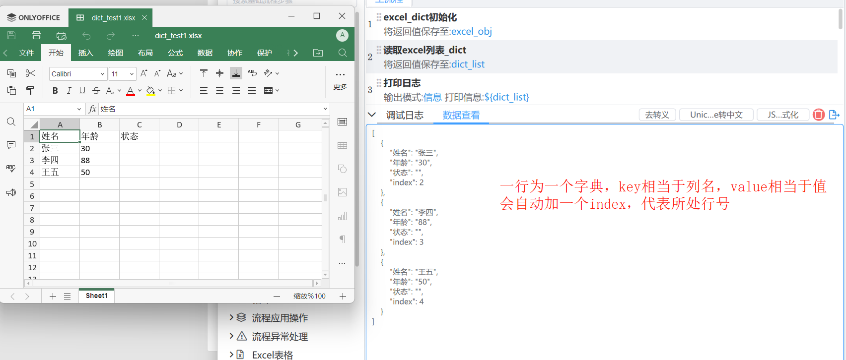

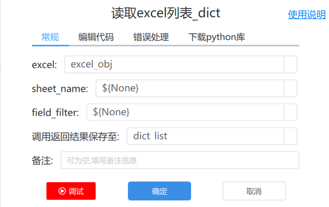

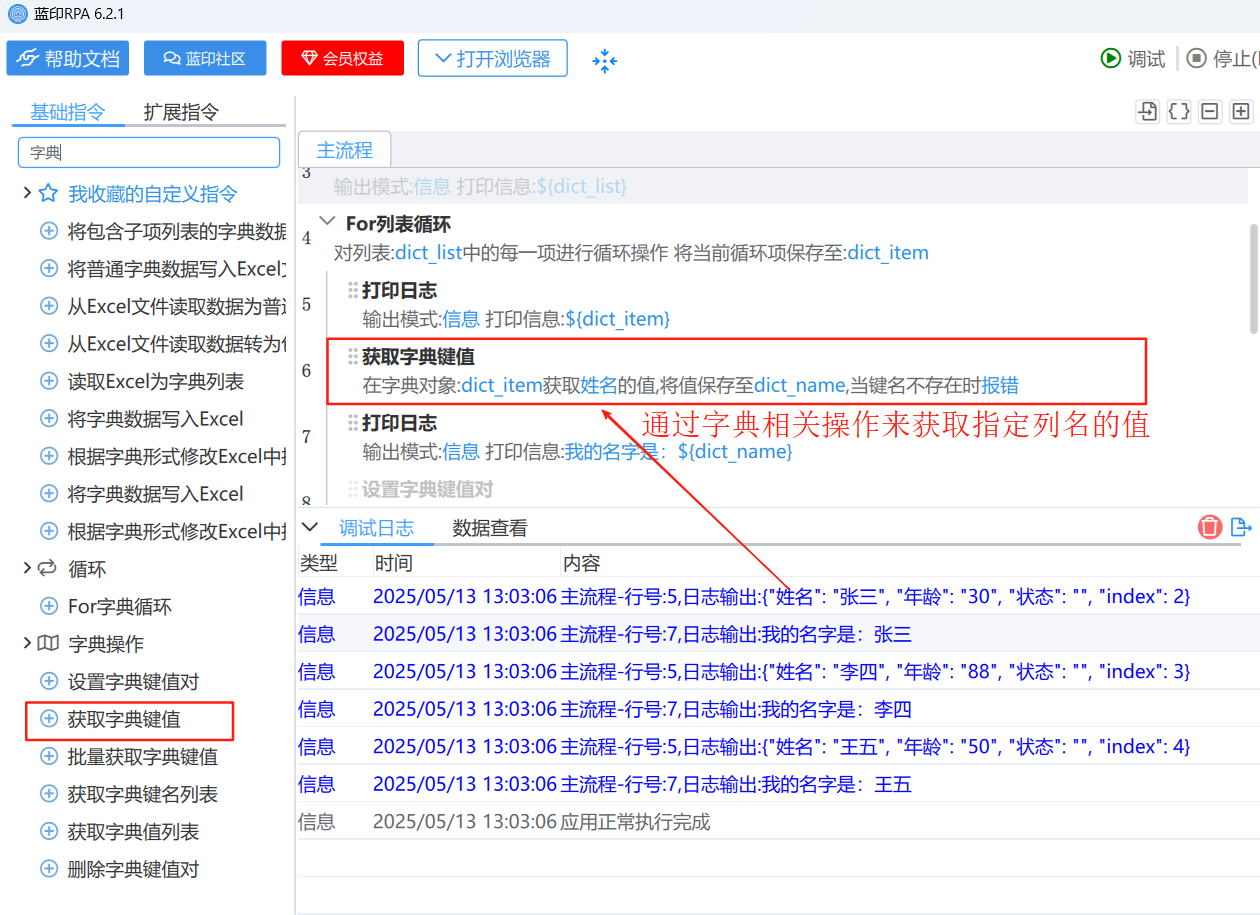

读取excel列表_dict
9287568986cad3f1507156107b2dfc2dccb5e3ebf58a5df8b8043bd220f82170104cd438b6b5c29e721f76498408691ab48eb9ee85eee0f1b36f00679a1c64ebb556482df62504da4875e03785eb18b1ff65d7a23256ffa3702986076da9416234e32c9756f4f39a590ed208c5b825b537fa45fb9c69dd0358a2c0d83a520e93ab3c5488f79254ba14a6f5660f4cc7e3362b06a14ae4137ff07ecde9d8cee55560757b6ec67cec53d38ab873d510e8a77de5306a8bc9dd6c33618e4e31517f8408c1c2f2332be86f199f9addafeb141d048507cabb77f99b70e562ef759b3d501fc2ef57369d4d91dcf980fbd4fb43b68fceef1bb655f1ac4a2eecaa6ee824cebba840244940285f44a6b207df2f1bcd378430bf5757a626b848456c343bea27457e50997591d7cc6d737581b9c6e022595599ed50398485c41a56a2dd26e567828142739c815300ceaa5c056f2bb2ef937db8b19c33295316269898065dd08692a04189105b8d0f0a95c8ff1e68f714410f6bde366ceb1713b4a5d9d3cdec9b5011df560c8921547945d48899a8931b0496c50d0efb658e870df95dd6b26b9fff7b3bceee1d800221a91cfcddb6038ac95ab0ccb2fbb0bdcf32dfacd73916d8bcc78dd876edf579bca017a2f304ac5a1c2ff79e14f8598a1edaa49d92ebad58b61942cedd239d931822fd6cab20d954812de245e25c9ce5c1b0c63d1d7ea1eb8da024b50226e23e92c373c0ae067bd618d6f2dae112846c9e2b7a2fed6ddbad990812526f1040a6c896ea94b8e80ac2713446901c6bc28210b3d189e7697d9d1c06053599c58177be13466b7e7fbc6c554d96195118afdadd3892e02259c79768241217c37b912a
参数说明
sheet_name: 指定sheet名,优先级高于初始化时指定的sheet_name
field_filter: (字段名, 是否为空),如('字段1', True)表示只读取字段1为空的数据,('字段1', False)表示只读取字段1不为空的数据,None为全部读取
读取示例

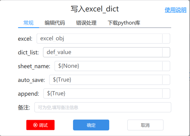

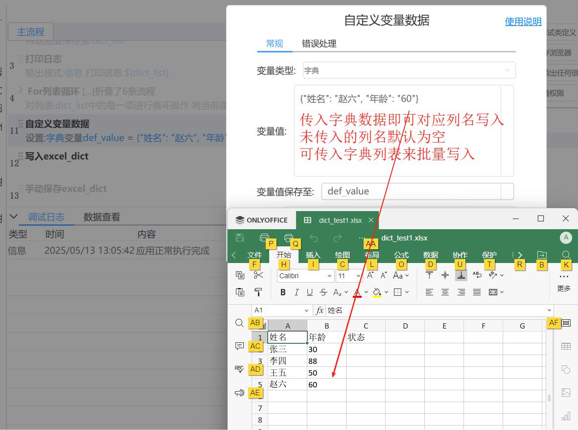

写入excel_dict
9287568986cad3f1507156107b2dfc2dccb5e3ebf58a5df8b8043bd220f82170104cd438b6b5cfb7501f7c7a8408691ab43455100e3b6a82f5630d72da5c23ace1435834f62b1cc05f65e144c2e114a0b900c6b42e47f1bb743a81072fff786d22e33ac125a8a5d3035f9d58a8e066b529ba20e99c76c5444ee6d5d53a5c7dd8bb7f1dd098ca1cba58b7ff650f4cd4af68704ea115ba5b34e73d81bc90ceac4064657a60de78ff54d7cbe9218e19abaf7cb56563f6dfca6a7e29aa1f30403cd22c97dfe737658d2b4ccd8d9ae1a94160158f06d6b60aa0c529a964a83bd8682d0bc6f24910b65280d0b7e5bf81a954f1c18cba66b059e8bb4053a2f27ea1758af4f75e570f432e525590a6168e764b866bd27eea1411ec6db8420632090faa60092566a17b899b48868fb23e3e4b37fad9b650ec413995cb0db0ae3a08d1d66a9896146bebd81e1edb98554e267df5adab63f6fdd17c3a10407198c25f1ad9dcdde75bb7134c820f4d9bd6a5136cf62e0c5723982223e46a11bcbbc8d3dbec9e5918cf4771dd625d7901a7dc8ea58a0b43c9d35408ee4a8c8c4abe5dd8f675d8e54538caa14280486aba11f4f7b548dc9f1bb9a0f1b7a3a1813a96f5cf7553ce978ad99f6abafc4bcff106adc945ef1c0f6ca1c915bf058848c4918bcfeba819ae5915ccc02a95934e47b16cb635901a8366ab0bf06296f9c8e6996d103fa9f7d8e579b70d1eba6990d40cc6b9017b980c86f3dee31a8076923a6b58e674d5add904545f631f50a6c296f594f1ba5088387340aa1f6bdd8c1ea992debf24509b132f066cd7c7d33df90f47232001fe6e030cc4154819a6d3d175c2ed3f5f9bac6d2e153c8d6f9f2379ca60d8db14bf241d489d0c84121c1cf1e9ce6cf350ecaee32f7e54c7d81a865e19cc28d4d78a4d99f04dcf3a25bc586e454f2e3b28b9ce7ad1088eeb57e5058c8b80f1571cbd20dc943123e936559713
参数说明:
dict_list: 需要写入的数据字典或字典列表
sheet_name: 指定sheet名,优先级高于初始化时的sheet_name
auto_save: 是否自动保存,默认True
append: 是否追加写入,默认True
示例

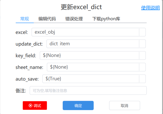

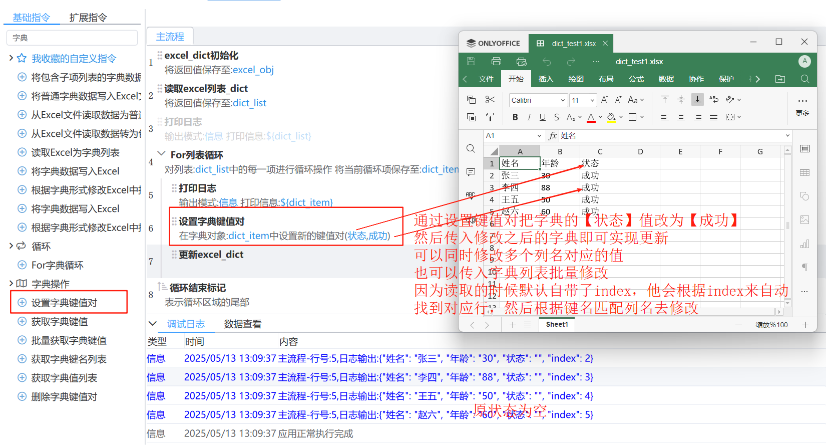

更新excel_dict
9287568986cad3f1507156107b2dfc2dccb5e3ebf58a5df8b8043bd220f82170104cd438b6b5ccaa7d1c6f6f8408691ab43455100e3b6a82f5630d72da5c23ace1435834f62b1cc05f65e144c2e114a0b900c6b42e47f1bb743a81072fff786d22e33ac125a8a5d3035f9d58a8e066b529ba20e99c76c5444ee6d5d53a5c7dd8bb7f1dd098ca1cba58b7ff650f4cd4af68704ea115ba5b34e73d81bc90ceac4064657a60de78ff54d7cbe9218e19abaf7cb56563f6dfca6a7e29aa1f30403cd22c97dfe737658d2b4ccd8d9ae1a94160158f06d6b60aa0c529a964a83bd8682d0bc6f24910b65280d0b7e5bf81a954f1c18cba66b059e8bb4053a2f27ea1758af4f75e570f432e525590a6168e764b866bd27eea1411ec6db8420632090faa60092566a17b899b4b9ba2b12d2b4b37fad9b650ec413995cb0db0ae3a08d1d66a9896146bebd81e1edb98554e267df5adab63f6fdd17c3a10407198c25f1ad9dcdde75bb7134c820f4d9bd6a5136cf62e0c5723893b24f141188aacd59283ecc41a02db4e268262033e0391c99b96961a04d9dd5206fb098f8805e15d91bc7bd8e84530c2a94bc64664ee06f9eea50fc4871de695d0b6a8b9de65c7a296395cc29fcdc18729bce041f5f638b5cd0aa61c552fbbdd1ce85a88569de182f4e1bb5eae5713c2d56996970118b137e4248000881bf448f066d8a08fb2c2234121dfbf8fa47fc10236f336c2d00e89f41567e555cbf3dea700d5609e282e05f368d7bcd0001143691948d58e8af684bcee46bf397f57815d2adb8c4bd695c2ae276bc4522a0b2592d2fc23fd0c46263a3ce53a4c739711461fea85a36c90a46b1ad6b067280d4d94768836218f3bc5ce15aa0f16769400cb465149eee3e840f44feceea7622e57cad31bdb235b8f37d496cb5e87a618b26b68e84f32093c6a3c23b78d32985dc6a001ac05d2dc98cf4300b22192cb316cbb70499e0b3b566ced52fac2e5b885a3648345bb5198a2
参数说明
update_dict: 要更新的数据字典或字典列表
示例说明

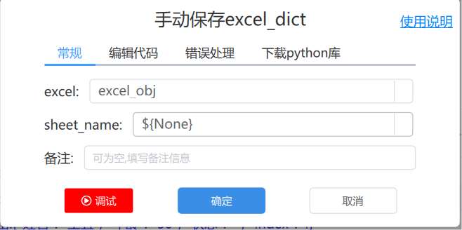

手动保存excel_dict
9287568986cad3f1507156107b2dfc2dccb5e3ebf58a5df8b8043bd220f82170104cd438b6b5ccb8421f737705cf979a75f354010e2a24f1b36f00679a1c64ebb556482df62504da4875e03785eb18b1ff65d7a23256ffa3702986076da9416234e32c9756f4f39a590ed208c5b825b537fa45fb9c69dd0358a2c0d83a520e93ab3c5488f79254ba14a6f5660f4cc7e3362b06a14ae4137ff07ecde9d8cee55560757b6ec67cec53d38ab873d510e8a77de5306a8bc9dd6c33618e4e31517f8408c1c2f2332be86f199f9addafeb141d048507cabb77f99b70e562ef759b3d501fc2ef57369d4d91dcf980fbd4fb43b68fceef1bb655f1ac4a2eecaa6ee824cebba840244940285f44a6b207df2f1bcd378430bf5757a626b848456c343bea27457e50997591d7cc6d737581b9c8c6125950a76c97c70444b9f7b92919e2e567828142739c815300ceaa5c056f2bb2ef937db8b19c33295316269898065dd08692a04189105b8d0f0a95c8ff1e68f714410f6bde366ceb1713b4a5d9d3cdec9b5011df560c8921547945d48899a8931b0496c50d0efb658e870df95dd6c33c9fe16309c8a343c74672ee14fde4f01987cb5aea8be6baa3b08f67c9e6887e46fc9cc98ed822f5d44ab0a247fbc91fa05b1523bedd06f817d904daa08de5e0b456b65c4cc28c399d9b0d0ff82ffc67d758c536f247d9658fe2cee6996d47258be08fac26e31131ff2a82c13687ec473cc74bd9
如果前面auto_save是True就不需要执行这个命令单独保存了,默认会自动保存表格
但是因为每次保存的时候是需要消耗时间的,如果只是几千条数据还好,但是如果是几万条数据,每追加写入一条都保存一下的话就相对比较耗时了,这种情况下就建议设置auto_save为False然后在写入完成之后执行这条命令保存

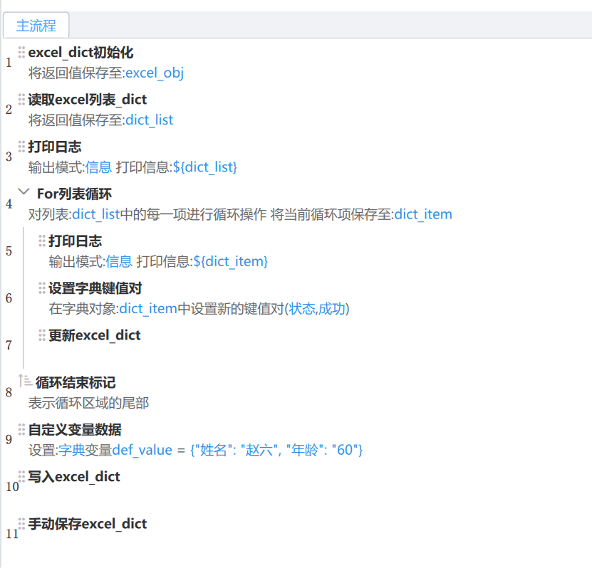

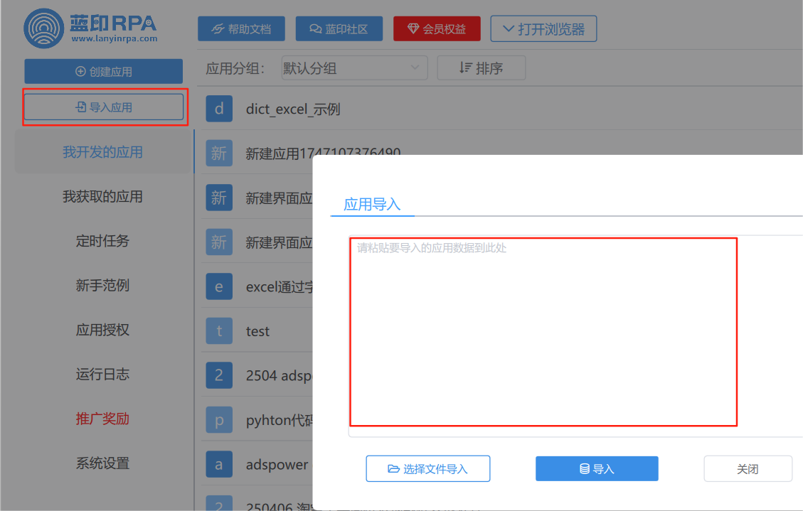

完整示例应用
9287438582c79eb95f7901107e2efd2ec0bfb5f3fec753b9b7183ed24da0695b4212832bbfa11f1cfbcccfe8cc44324dee46531a5c2c6596e23e0723d95374bfb9561a63bf2550c7596ba72185df1cbafc62dba8790effec6d3fd15873bb05306aa437907ae8b5c5031ddd09cfad32f370a829bedf679a0301abcfd22050008ba47f4696db9e6fea4bf29a245a1dc5a4613b10e54ee60473b87e93b0878df458734f6c23897afd43949cfc62d811ece62cac6f688b968d2b682b95046c176c8c4ad592a21377f65d53aabec7d4eb7d7a41d8438cf56eacd629a960a83dd9781d0385a10779ec19de84b7a2a38fed4afbc29dac57b055ebaa114be3e165e1389ba3a3667349563c434694a54096374bc135827df72a06ef70f61d5f2a3637e72e383072b43c91839d2c3425deef5c36c6dfb57ae65c78dbd80db0b32f08fcc35c8d835f3defd74500dfd70a5c307de2b0bc74e380893721145f26c7d118149ec2cbec54b7184b9b4e42deddf35f37b969024f6d932a24f65c11b0ea86aaaae2ca5615d74771dd625c64049dc6b0ad960d155177b2cf27a00465fea65389f160c9ce763fd8b805983f33ee1ef9efb548dc9f5aba8dfbb599acc233d2acc13944c29edd869f31edcb1eccde3b87f914a64c0a5191e02cdc5bc705d1ac8acefcb44fbc0732b2f217bc990f08fe68a8318628bb18dbc027ba1d17032235c8d0ff4b60093958c92c1fe632bfd936d6a23942e66ac0fed8f1658361883a3f5efb60c5b09755584028124594cbddbcc2b5ff428438646b871e7d92c510ff92c7be2e2dd2507d18718a84de61e7434d6b7738b274015f8c15550e9cd19e6fd5a66718c5a968380441db24c82c1b857dd5c353b657080b9e08c5575f53a7e7e46bfd79eaf0a62f7a41809a5cd91d599b3f9380c91b899416816b6ce30866763c6a3e3f858f2f971adeb801e94ad0c684e4051aaf1ede976176a6345c931e701429bb5ae5dbeba89de602d004ed00c59370eaf88efaa92d2c3da44d17c11719f804f5af5a8eaf93c3953d7edd06ab041489d032bc37e47bf46d422df0c65da402aa4797aebc85601762e4c1c9d244a09c6aaa4821a20c980296bfbfeaf7996eae57631b308338cf167d285434590be2c020dccbc638de264953f2d1999fd1e9ee75697ffd2a2ff4a0b6e42ea325177d3a475207ed76f686ef06a9ec484862971e8378ed515ef60a2ba57b96bc92b7494522b1612964034c249a25c8ff44540f3d08d8522b97da6f42887b3b871abd89a0644d20a979369ad97558746cbca33d9e3b0b39addacdc13c9d89f6e2ae1a1a415d3d1224584008cef95343b32d063d5f3a19f77bbf015deb919f22419e22d1ee6b13158f62cfe0419896b501e6d6ee4c261d9c45b19c2e78fdc7943526f4ab881c9f3788a10decd59fd4ba8d7cc84d20f62846ae5d4918f95587f1324a234f336a234fd180e2b7c6e7e2b28f0888b270f4d7c8da8373448974c6b5665db8281f3c32fd3893851fafddb53c70df0cc12c9232bf5c0572a4c106ae5ba90e6f3335f9d67ebd6caa6c6858c83a4ca26acf7987f36ceb812ba5d74d3cab3db174ad299d8ad2e732aaab747de318196e063d372b870987cfe49f8c4bbd4f87c313d45abd247484ca26a7a387c757ea4cc61ae093d1a8052cf0a1ae549e0ad8623f2fb6c5f11e5e9df34dc263185c258047770ac22c0ef53aaf95d2de99aeb4f4b5e56c6d74ebf8bd165af4cf52fdad3ebc492f13dc766e5830369034147050abe5ebe0758abfab016f9da3d572d669ee101bc50a74f9b8f51f89bcaaaa8b25703b06ed72bffb943ee360076a0d67eec2725d6eee8fe06345dcc8d725a13ede325355e59682ffea637ee55097382dda7d94fd6d3e742f2855470062b10df1d5ed9a54d5e9d67f5088ab1c8a27a1a0ec6f143980688e4dfa6d6863f26e2054adadef753a93588c003de1147a69129ae05319472045b0a1e9a57fa17ab452167dae855e0a52449535ef5761d29102c77c75a91b4a25fe8f76b8b293bc86737177a9aff7cb1da27c8bf8a407d62446d197511211f727e385e43563c989d5d8adb3ff22a039b1f50849c7198e436832d225b44a7df72b8b8545875fd025aef66e9039a7342f52b9d833b843af495bfef4c9db089dbecc2b8461c3ba0ba00f145ed21d2b159ab0eedbc3991d60026d0ae87adfa7eac4a659ed27e96f334dc6c56c2670e25b843e7e81083c04725777b9fb79d892355525b11c30f5eb13dc8fb4b694be219977821ec2479a51190566f2e49dd688340c390b1e9a0060e0cb1df04170ca09b1b7a96c8e452508ad33bceb960d217cd873f553aee1978a5a713389c4e857b5cbcbcd150a6123a4abb14401f971c5dac06db8546f00e3e8d7c885cec6b838c46d1206f366d658e559c2830395cc6c66efca367b56566e327a8568e4121e100a3ef0fe9744fd9029924028dfc3b88e5b46ea3aaad33a79eca6e4631aa68cbf77b74c4c035f2bc4e9bf3d570e2a512ac3abd079dca52a00b0c78fd3e65e35301a58fdcc285ec76f4e1ab11005a06dbeebf5483182223672b0e82ae650674b2c015c9862cf8f2f0a727267c7de5936b81cf76d66a30243fb5c43e23ade9733a91e5cc5ee3c180b5ad2486e8e864c2758bebf583689e65b7dbeb0424f60c65aa6a55507c64d37e07fba28e38661d5940c0650dc701af2e28c06e3878616534378ab8e0c857a975cb912627142340827ee3fc657fbf4333788e7d83d1d26090a4cea4f4c8a1ea360b542df2aaec8851cb8f9485d34744e1435d9298f623e5b0923e7ac1587135a4d6708cd108cb4a77b302394eeb1b8535cc1a463e3e9094dbabcf98354c27ea2fb0602d54ebfc433bf82602cded356ea5f0228b5990786203c4631aa37b849ecf98f612a2d59bfef1717dd0e0fe45930d4776e662528bc9e40955676453ffaa6213be973c07207d46ef4e838b1183bb460e8f19ba62963154e3f58c5cdd8db02b1e5aadb88519f8776b0b827f404f2671d3fa87f1ffc40ed76870d8d843207edbaf6ff7071887548ea15f70a8b09662520e12fc6b9fc646bf22160d99d22fd5aa704194d9784563bc3267b741b1ae50bda05dfdb2c2c3cb58bd9d972dbaca7eab109da5097656951e801be525898a499ee3d5821f10c80e763c7d02ee9370c473ae2ddc4f3f5ce209bc973ce09e5408164fab4d4adc3f07cc0efc6f13025ad51760aa00ba85859e27d6be5391d2b0c798e5ab55b31af758d1e428f3e9d0b39a5a64be80ff0e48159be0e8fc3e47956d9d0ff6f489181669b1d3fa22658c872dd819ae04036753cb7ddad171311f5262dc0306fcae4cd55311927d0470316f9a05f2df1607d1cad2e3f35748b9e879b3453c6106a0f1aa5f3d06d0df0101165eb799b2620026c1e1de3252772f7222cb9e77a6042c73275217db266f9bc3e0ccf689b58fa6e005deda620c06cafc353f4be790dff2344e3813da01fc606ce52e3c3215351be0eae9d9084cf112dc5b445f369dfbdb055fd4baaed369ec0e67c77f0c38b9369f611ecbfc4dc649e1c9b115bf8b5509e39aad1cf3d778b0e42d11fa3daf84f8e06b499e651124b4f13e46a00262ca2106e12b8121a8adcceb6d724b79cc88795178a3db4649a20edd837ec9049278046d43598ad009b70c3c56f46124bbeb82444182189e27bd0ee3afb76d849f2b2eedf34753bfd9683654f31443b414fca2f0315f61e43c8f6d7859b2f5a5c0bf8e02104f10564bef4856fa7718893e47f4e35aae74715e3ff9fab44e7c343057d59d87e4b8031c353a838a1484ede375f3a4b69cadd4b08552d12906c1a214c7769bdb1b8d25db98b3fe53f0ef8feecbaa6d153367e4b53a6d065e539cb54d0486f37482f5358d0103b4d6eab8d8cecb5aa4f5c5e82ef621bfb7f089116825df95146920e7f578d3e619e394083f896159346443c5fb688f27e7295555838ab940347f51bb527ae4089d8d418f9f03fe45898a17553611a4b6fd0d8660e42d2ace8c0f612b1d8d78e181962b92356dce91f89e5ee23c2377543ee16b93d44916d63499334cc6a83b1b97c196c004c58e86fb8ad4b3c3c0ed5ec9bcd45b9ed662d5e41083f06bef1f57e7c09a259bc78fb6e444afc59d465b113f138855f0c42d762b8ac524cc180d480a99394b41f1d1f0eb112a6b30c85467baf3a74a7f736afe84012c1e10f8611fd94a3e1846745944ca4a71d473d9b26966cd96b4ad7dc9105ea0d898e09bc3c90a04e6b4c8117fba38b0cc3ed5ffe790595c2b1487844946985ccb050bb47f2e3d1e0f67e19de97eb93431963040824553342037bdeabd035393538c93d9f2df8e610bc3ab0d882e9756c0d33baa945fb276189456f5fdfd2ca5bc2d8650c1f43e405a7fda6f5f1248c25dbe6db537919a324c9a9083359b2d0a567328831904354b553419704ad9b6517f2bb9a3b4ca2e1543a8ebba98a264cbed715567ed4654bbf04e5de5b4468eb8a451144486d4137794cfb5ef1c3db7fc9027565866f78a313bb248de46f3a25abb55d1fb0766b5b0fcdd93ebfb8f1418ad52cb701332b1f1880ef89a0f86d4edbaffeda32cac83ccd1df03e91896efe707c3b71aaf0c04532c99945ffdc1e8e4f7129d1e27ceaf425550589924dac40cd72ca9062fa259eeed9658401f8aeb321bc91bd1ab7f58a15e8c02a607159c5f092143f1df1fad750815430c040926d4ce3a648f079e4cc5021a081f73776b65e332ad11a43b70b042627c1a6bd5b7cf8d3397d1c4df5c1fa2bc99660a3ae134a2dc77afb84c38974e6f9ed1e328968d5a9fb84f262ffced80c59367f55cc175370e0718f36ef01734a22a3e304ad756bc5ee3ac9a35a010ccf89a296b97242b0d774d2540627338248657623977b2f9e500cf970303f4f36d00fb8e02a55e5a5b63a591942c7fdf440e30f4625dee28e5b626b8fa9f2353ba8d840246d97c4efe4305a0bcf361273f45241f37889965d99745bbfda7a793220d482591cfa258f4913e971072614bb42bf7418c38a1d21403aec88e35486696cd43eabb95eb6e63578b8e9f5fe9f07ab6a4342221f60b3148eb01646b79ea4433700d4e953f903fd06330e8dcef2b8caf390b4d57dab92f0691f087a4b039cd82f8ec5f67da766c32af6a8034e74828f0e7e67e58e395c9ea660259a01373eafbfe57f68b4610f283c826ec0c9ef4a8f219596290a60158d42260d7bd921f97b83734b23065825d723f76a37a97de7ab00e7565a688ac00fd2f5ed4e21826a4203f7ce1ace8a2efe464ed0a15b03e2be27a8830f9f12be148c5a165769f336c3eff966bd61adffec763267b869eaafac964c40f5bf3e5e3138d002c5bc0db69b3e54d06dfaaa0a1e35ebe9087e49e143c863552b41abe00eeb397de6dbcbd582642e4e87f9fbb441f43f5efa9d914f9355608d7fa294eda09700f69f748688d3ce8de0252feefa7387db605dd11f91a002e48431971ed50bedf600bae1c584f0f033ec8bc48c952b682aba308699bafc64195e39b3bcd9ec600fec938b3870c6198e90ef6cfac3a8477da3ed9cfc63dc59f5fceecc607a6ffb8962d7e1d3b9feee32a9b36c543beb6ad642073428c869ad4bbf14b74d56d4259f95903abbc8819ae3c0d566f06b8c0df066a03f0d946487e4b6846ccb97f6a51bd2d6bafc22feb80d0d7d4a2817a2930370900926e94eac7f23fd27eec149a7848c15ace141b5f4006a6b0a162ea22da93a0964f27c659c5c208c8f2cbe3994073b98b4b02c323edb43a640f9bf442a440551898395bddc94a3beae320bf8570e6e78d54e65ebf171d8796b84bb966a5c5ba6150496297172f76681a0f6ddee3fe4c9770a43069b289809ceb569b96325c4a5cee1d1c3cd4a1469f5fa9b4aa9f05478f764a5e7eff23282728ea96e7c1800de929b1a2c5476dfdec655ec4f858a2fd24931ecd41bbe7b9177fa6aa9137759023e75287236b50b2def419c5617ab27c75b94e7c7d6ded5149f247d14f82028aec0e2c43e8dc7776852d4dbc23ecada4249f1355945ffe44433dbed03a2e8b2f8abce92755d0402630f4abd20917103dd6376c9e76258cfd575def55bc084f067e0f8267baaab27b164f0c70f0e2c967806ee5e6f2cdba98001331e7fa6bddf466c4d0e6d3b611d3202b6892caee85bee505f34af880c0dc1266d14ec24cda3c5afea8fff1dbc83be78c371a44a252a12296e7102dcc72bdc2b8b32598f048c332b1eb1d1545a5dac2577ffbec85f808c117d1f782cc0c0cc62d5476e40fd83eb472dcb33781b44c66ad75eedd7c530ce200898bc8b4d600c2fac18eea3270680b99a800c4ae93d7cdc7f6dd26b33e289c696b6a2469b0d19e6c85a886c3746bbd9a818af6bfb3fd439b0bb54b4609fc635a5be3c2cc32426fb35208809e191a48ecddcb5e6454bf6972d35955414c7f9c9ae975e1fc4834c1e8b4169a2196321cf58fb5a0d22bbc906cbc9d335ad28343c4ea136cedd63244fd54602c9e73ed535150795ee8390a42ad92ad93f6be78e5f9fe23d3f392bf09c244ded885be1e5ffada41e26600bc89e00c44c7b657bd22ebc2b24d6e02dfc552679d429e3d0914cf5f8b03f438b62dae1a68d0a6810fd18011234bd44933e50ff4f127ed66134e124149570fd81e354948e1788e046b057ba1d0fedac3320d562e6d709f545072dd319686c1cb64a7dfe844b7b39a2265091c0219b78b27544c66a21325e6128e03e73cc282a3e319edece4082df3632d41ece0e55940cd9779a5a537a31e93919efc8d541b91a65531d3ae9b0815c6e91fb8097a4d43a2f70ff6afef403b1b366a7ca05e19a029e922b9dcd80a887f0e54d485d0ebd491514f89c7743a7f5e2f9eee6a443986dada661b7cf133db3e517145f4ef387280f5286e9467f7721f6416a149704a351ff872b8a8f49ce37302b5b651457dcb1a8f93d99de8ac3b12799a6070732b7a4f5effcb1bad3c84020327d7d43ad2e3b4cf7d4c32763d2f7e10369fa331128de7aa7540f144a3500453b619c5c6429db43c29c633c3b73acdbaa09705c861be35322b9030e260a25673a423cd4c969a4a0629330af83057a6bab4d20314ce0c4359400b7b921a3379a721a28a91614c512bb2d7667cf3402e8b222677d1f5b34812d20d3bcf32ae8b12bd3ad9657f3913bb4c50b868541d036e79f5d7c308d198aacec25c8d74f06f7a2d942c5251f1b3af55284edeef69e43001218f96e72a49809226663a9247143b55e135f64476ec042663bd02b87ebe4ae297a686a97e682107540db8d7931325108bd0755fc42b16d2f53e68c26b89a294108aaf445c3163b23a172a1b556aa4703c178a7dd2bc5131a2c7966c0b9103e471bf48ef755c6d9fae19abeaec3bddc95285fd8d19098c036299b11b2926a36eb770194b602a532326da1a5c085f5377ff56278ddd3f66aa14725e3be79eb1e69156e00366bbb2b281e023350d666cc40099e165845a5fcd520b2248ea43713401c6902e52220d6b2296594efaf6482bfc38ee09c9b66c49bde8b9d0040139ac74634c602e495a9541a5952ae3e3c9280bd869a3cdfdafc5d41febe460fcdc9663bc50be2d0bb8d72e99593e5257ff6a368dc317d95ffec663400da3145c1cb28e55703884531615ba0dd6bf83e4ab3f3f06b2dac3fcecbf78bc9f049c3e76934d69d8b64fd8f59ddb7bb6c120cd64293183c597351487144321e533261b76ecd88e75d53a3ec661b76a0eb9d86a93cfbcb40a85ff48e359a50c6ad12b04c04685cce4d648ef94dff2f00e3b2432802ad6b23949e440f0dfde79f099b46a4f9221a5b748bf1f338f39377d8e12d6cb7e6128e7210d8e4d9b6dcff53a0b9355561e4ca07c48db69fa8bd674c1cbde7f78b1477c83c3c260c01168f0ffcc742b7bc594f925409e769839fa03ab71139b421ec826f093da2047ae17607f0fffccdc835d555874097842fc76190931852916ba6627c5b587c85778f418a0f5c131e3381d71592114ab6b8461dd425fa65d388ae917444b5341d418e533875e5dcb0494b5eedd1b09aa391bcc87b6a53778a1a8941d6ddebcb99351f3eb3af5c7ba2d5973160ade59f800c92fbbcde7e392b520ea92666f95784614635cde193e822f5dc236907eab144626981d75d5907723e4f2c4894a438707bb19b1d9062d57d5ebfcb0afd3757c84a8cbd0c14cc4c4251ad8c5cee365ed3b8ddcb953f1bfdc69fe1cea2047a388b73a71f7cd7541ed602d5a9e6eec476b3a689f5bc88dc1fe56662f3fd8dba7b57c004d9362f09f94f18c5342c7c1d831b3ab1c64ec713e33304ec8397c8ce0f225d573335ca3484e41cf980a341df3f9c97653ed83a62e0c15102301b05a3c954c04b3a938a8ea98b4e0070e3aa71f850b53920827a52480c6e3aa132d9f138081acdf7635ff0f73d0977beaab781614e6d3194743e974f7fd74b5b9a644ff5e39544f307a743784d184c0828ebd36c0cda1a4b3cdd462a1ba55d5f4411c005325609c9efdebb7daf4424db0bb4efe247296d48263fa7dfce4fd0c279ca42273ba89203c9c9121917fbbaf48a9f18a83a179c8ddd6517503154f01fc4f0d960de3dca38d9787f1b47d41e8754ae796026ce8565ae093c3436d5e39a8f5178c12f4a65ad33f39a7c4d9b0e6de2f32947cb08447aa6cc60a3ebf88c11d8845c1b3a1d9fe1bb80671467f2ba1e13fdc1a378e0ccc2a157095bcc2110712ca18fc14860dc317a329cdfb2446527cf2085d1cf0b780126052a1956fc91df952088e9c40b53752af579a994937eeaf8a1ea33f0e44d221aaf317c54b73f5781582930b5ebff2898378b719edef6ecd6dd657b81b2a087633117919f2907c939356037650e37a1f6a6222b8a439361aa09793209e2444b931c9bd1197b015363ac2f0ae515fa4cef9feaac7c0f18f32fde4f09ae23c1ecf96757a04ceb23c3f99d3f6cac9e259cbe952205aa515b7f331f5a4f09517a8fdffd5ca0976dbff16279b8eaaaab90a7ab7e8f8bbdd1ab2469b22f435a62d030632411774f3c20c038e1ee6c920560488effb3b19245e6ea2ff7f93d768aecc6709c2a250d8720442a972fa548f83847150b18f0cb6aee813b1098caa720e3fa0d2e07ead080ec33c59c02de9d58b0d92aa8ebfd832d8e98423183d5a612ebb413cdac0a34ebd5b88230ad0bfcf75171048c1189d7b051782d5b074ed17f4cf30a1d88908808b89a84d987887946a7d43598550aa16eaa70cca0263b106543b855f774bb42c0fa8cf5f0395be12aee6747b7c46058846104f8c5e2c5644c07c1b4b421fdb19ab2cba4af76bac10b34fcc4ce04cb758ee089053ed59e96f7050188e39808a106f0ec6a46ef69bfbc56c29032c706d49697da5d7b3c6ca9413f7a88cf439af8468d075f972b14a7fc3ad9b6d5db48309ceea64a5221c9b47a5070c5243622e6b2d56e45fd9f0771da8c6412f216446e8c8d93be2413a12cd12d28fd771171918d3f171f490dcdad7b5a40cea2304d973917d9d2176ed085d3bd33d0e4125232f3df460c28c0a3bf09cf7152387ec696f216bb3ece317d2a7c51c05bf5bbfcc1eb43be2a4268a4ce44b081867a8c6cc895f1627aaff450b0ff3a5e678d2161877f11de0441a45459c5ef37c649a913eb5b7c774c4431332f3a1233ae7f3941718b64479c3c7ae675e5c714f533df52208b9171c658dea3c3cf40e88977ffaf3c6ea07b3fc5621e4478691f09292a2b2e9afc34f2b56081ed375e8dcecff8d31736b0491e5314c8367fb925d6517bc23d643ea28841bd1f4c37aeed646f5c69951c21ba9641071981832cefc8abfabf828373c678c7f0896e95b97f63b877e678c28cd69b641d539a76020e23fe63fad5641c5147b4cca718bc8f5d4765ead862075f4130d413e0df0cb20ed8c0a867981da047d7c400faa9d433249e14b923f1224ada827b088527b8af62f300881cd6c8edf6f5773970824c5b6ce34ceab8038dd51e11efa94298517df007e3be6074ea59d6541801ab6bb9aa75d1c017172a15f9e498684a0c482396a682e67a8bc0dfeb1a3436fdc1e9d47434c9cb0318bbb6aedc6b2120f68d6732a14347bd9ae91e36e394c384f1f9a49db7d48f0563cc2d29b893c96c9cbb6cbb50d9e918f9535f3a36dac8040061a448467657777f9f5bea977093308e98194f15971b057af67c99db85ffb9d64ffa4cec8070c47e36b3d97738c78351d501fdd18ceb8791736b54a86b19726948df35fd2a601208c2f72f23e65ffaf752d0305f3f71166645d4d4465cc74bfada25e7179d55bbe89615fc973f5f532ba7b53fdc9b90b4366232fb9b3f95c8869f588bd116b48b3b2deb38dcfc9439deb340afe03c66add764331f37f5b9944af5a7eab7139cddeff8d63347b79720135c0090a99c8f2adc0299baa7d22c4d1a2455125953026e45fab689ae4e8ba3b2ef13a09fe9cf3ec08e7d94fb809366618331ddf2dea55e788faadd3a600ee0e279198cd4d1460f39f2ac075e76da56e8fb1e092d637c7835b40ec6da425e3b90c90222e9e515d196666178efcc6acaf3f126ef49a6587664c297bfe2043fee42d83f5fc0ff2785e5a98654806aef1556c3934a4bf953463e8edf25781a1646eb8b6187b919e7128b8059efa527702dfc487b6126e8cecef32a2e546273e700cfcf52ea132b832dcb97ce7c7a3f856d093946c8598659b64efb0f80e219fd5097439691f9e2c6980181691f49b9c6d8e49274d523ade386032f25295b85324a560369603c6d8588e5ab24fa3c4b70c1f7f0f2f2a869b68e80082023f08972836071f2186baec7aa53cf292386faacfa596ce31434c9a10f3dbbd1134f5eb904ed325ebf9ac19a5013ba445478891718a97443c1b7b1a0926edf334a43b8f6772a17971c5985ba9da65aae430478ce9c3ceea44d595ec97779143e8d643450179e1a1c5bbd3db505df51d314fa09d9134788b59cc57f247038458fced1e9c865ddd07588c1363b74965305a781100a3c8dd10e990b36da1acfd23d78ccdb047886ab37ce44eb817151bad66870319a2d0ffcb104ec6c8a7c6f97f2de01e58dd107aa54f258524f4edfdc27164df3b0958c336a6b5279318a3627b8f75c9b83d2f29f3d986d6b4c0dd3ee367ac63a0a06262ebb4f96ed9c4855791a7dbd80661fe4bd80d0b7198a3c402b8ddc18e8b166c55a64ffb5c9c29ca7d5c42609d63375fa2df1895a6455eb1581df49d98c40010251daa6eab5fd7e843979b2f4759a917dfec20c8ca30e4ced11d903aa94a6d0a3096ff225986c79a44187975066b2bbd97c85cd89f5430381dbe0e7f1ab766858e3d84ab33974dd9186c3c4798f4f68e95bfa348da97ea528f5c935cac71ac43d67963d51b114eb6f5291bdd9887c664b896e1bc5fbf69a899a41ea1733ec7df8ecc59383fa516fade17a43e771e7ed45f5bd0d57df55d9f2937e0967f57a0c3d7eec0dc4d1b778680d953ed9a1bec1a28a37e32368324f36201fde384967fc5192e441307bd65e31af2c07d7ee70634593a5c83b6b6d45a30e28fe81f79d161d58ce292585ba62896a64cc5503fdb7deeb498b40144c90fa32c6b3afdb2f7ec387f52b568a42372b0bb1efef1767b66e7adee11458728ed0333b0cd827f50249c763efac79638f7580c7902e4ff9f31a84cb68230fae30ae8267f277973eecf1352b0a3259e3bdccee7588e5f316d8d87b131e351b62265b87fb54a2f6eca560a36c1bb3fa4cf08396560307405677f74e286b20f14a28e4283d7b5c594654d046266de47ba6215ecbe05735490756852ad04ffef70d1c2d597ab9fa9452c75482b2be0ff5d6ea64d023008d822f1909fa346a2728ae56f185a8eb2b5ad219d88ea7b92cf7f8ca16e6d2783efede1762bff0494881896a6463f4a4959cebc183eeacaef05f5022e0ab2e2699ac83c7e22f0e780263e811cdb67c6fcbad9e7d4b3811efc65a442ad3ddd78a44ae7fa53b7b68cb0ec203ed3fd51243a15c977f184d633b6993ee57c419d4715512ec4b772a08c3829f71de43ee62e9a9ca834483191a1cd821e1b4745b30cae38b828086dac402d1de1d0db1d3d652df2c716c8317d25a9472862247ae4332872e9dad52a7a8ab143b602f9a70c6d09386b10657fb51164920bade755bca77b004fcb797154eeb86490db779a7f08fdc19e8e99fa195dc63013f28cda7171810ddfa30380acdb339829817e625101028c8f50733c5f58bd676400c54b9fb6d6206a01817220e0fd9c0e8dfe7f0d3726d70b93d4705102e77f185af234305560d944291d6fb51f0bb2a69c5829266fc187e96ff71bc2da66c6bb22ecd74e11e6ac942e7f2ec8ea7b6a289ecd689c73f6fedc6ae592517cfe5313d041f15ed8bf97e7176fc317e181253ccc1b2d401f2d025a39e0c93e1f7b4491ac7c7c9097473218f4d5f5507d5b14cffb1a7331dda83d1871f593a14e0ad93323e1ddde030ff621d53ba65a24ae7b0b760b9079eaf0c0f63e8555a2e94defbb0c7af9050798031aabbd9ec4ad5f83a456063c8936224213a5ba45bf4869bac1f16683fcafdc877c064ecdf170c33b8caa641ffda2155e258a2262994cd5d3b25034be74b5e16809ad29c1749ce4c47f50f79cb8cf0c507e92f80477dfc83cb1cb49b1ba7abce8f7e11e8a3386357c1ba2fad0c15ddbadeabd61ce6507c916be67bd86b3d77a1f5a3817551a2c45ffe470219fb83ec1c9ff63c446f223cd5a067d8f9588b1f7b19fe3f2e6bc310021f74a17a8679f023f94b3da19b1856a53831594c13837f19e3380b6d0f8efee47413d7bdf0518ef5a0eeb71eb002fc83beb1580cde056bf9bf9708ca374325277d21d88d5d4206cf7dc86ee631837dadbe812ca4589006a9e98fe575bd47b0d762ea9601e14e9976978c4dd401700974b1f302409d922604159267ee3cffab9fcd66e1ea1c6f1877b3ef81663089d28af700f1eba762687b7b19d3ce89d30c150f6bc4af38dd9b3967c2f2cc7a9f68c58fad280ad1f0418b3179c71fdfb3d9b55e53a761568f2155b3500c8b5343af5c8845e6a9867de2aec7b3b72cc1c77126162d308a1d99ea858af62e7345fae3cd6f1655e4665870c46979891c5cefc05b775975d72e71228e25a548257ae32c93029fe4441e6d95cc1fec2726f3e0a0e1b7b592f7a3f67dfafe88681d665b0769390ff7f56e4d1b4c27c948faa194dcc97c671f67c4727361b07bbcd4fea5c4a334b62b23440b6c71b761633b0848a414dfd1d1694031c69c1b6ff8ba7d6e7ba70ea069265ab97b3a06f7663a6b832de58d6c51ea904092b13769e0135a567421263cef3bb09cf10e0ac8c528cc5cf1ebe23a43ade85677d6eeb787801cae1847c12e51fb0c1d4238e19462a75103d395575306fbf868736409a06a5b8b97677d067ed6b2c71c39b06654794180dd8073190edeadf34897f03fde336cb97ec626b8c88720a0779009fe99fa01882919c16695066253a4f0ffc68dad9bf9ad37839331fe07cb216935eb834bd997626f9c1fb3a0903b654c943e1ff74539b893ec33be50d130bc9d751ea49340ca1db586e62d2795048bcddca9a9bcea969869fa824044579270290dbb8be457dec376e5f0c17e4e3b165a1b0f62e3c5000fd778842fb8374ff244016b4e2a71288b29c240a6ab389636b5fde05f4fa259a6b9a8a39d578f633b4b90ba522c13f4e9a93349f16a473f41bcf11732115b0501c1ceb53295a09080861214825458017b86daf053d03c6b91bad5f7b004a8fab23e79b48b6573143a54b803dcd7d2931389c0f9f15a8f1d30095495d0c7077e3b319f12b14476d15d56f04b8f7e9e18f4622de2d5483c4dfcbe24fcc0611ec8fd37c819648307549459c1f42c7017c0136c9267ba26f8bba70bea7e4885b459dc7395403cdb902be7221a8f6d08a785fd05cb86517b0f8d2877a1a9bb927284fd6b5f0fef7feee2bd266cb36b458d719fe67b1f7afd91eb3c7b4b711bdae8f0799c8a26255073651ab45549cfa38cb1148228062109036f0376d0617d07ee80790f200a45a1841c5b30f29897e2200e183ef16a9b4ffe8ebdbf309812f4e0d7c48da508f33d8e17811eb7c63172db0188fed90464bc3a2f372544ed54759ae43abdd77cfcbbb046bc79dbc7a492a23473cfec7c443e60add9c092712294cee21e1c110f52c23963f7137e6cc5365e91aed34c9b6afff81da4a42a6ac1bf0d5f268626d9ceb9fc7cb1098e0fd153b2a5a3b3e28385036667026f265610ba68b004f27b39e76da0379cb682364656459e512ee8746c0eb291aae9c5b5225d683f04d8b1800a32c29df171c7a4e413d0e20e2036f067b9a2f41a9ccdb020770a377c91aee341fbd724513dcd3701e72dadb9f557c4aca9ed95f61053ea301bf3608f311bbf876d88441eb6e63679cc5f8719c4a148cc08bf696d542e4b8edd5121f8a60d49f65777c26904c63655656a32c2121081d046e3c4e654316ef962e3627a909e5acff23b189dac4c080826b630964956e2e49ed142f3256306b3b36b1e5e70c36ff0250c857222be4fb59604ad3bcb6afa13e5fb0ccc886fe2fec6d0a73e75846b5e021f6612b5f09ec58a23b94826b97692874ae51d5b6c422061a12756482d0af28d0f2dd2787746e87506684bf4caf630e4cf7c8fd0363ee47c78d70a8e2bdc85bdc32af20cb0b75a575a090d5568ebc50b22d6f1ed2ef22dbb99596533d4877212308bb8189df460728a94fd2789194ac2351ad2ae28ce3f0dbbcbccadb8f7bda1d5551e311a6f2add29efd4e2fb6edc424f6f26d7024946eb022ad6fbe43385b316c5aa52b3c67fb64dfd807dd1e7e6ed8464cf55f4253e67ae89832b4223ddcdf777aa6452141814a2d74d40daa744a83f7e822449400a045cbc9ae696915ce8dc18e91be7b385e4f25f088913232df91be67127526abfdca432f197a4e2559b7b98d6f6a1bd97e25f1165e30c403acb601c900bbd0394c76319aeaf809cbad8ea46b9b3ad807fabe5a8a0e1bcea08d2ddb13c6a9331bba4301c196d25ea1e9c7fe76a7cde7168cb51b5a5a6a8fc07266134cb49c16cd66d616fc0394d01ea3b34a1675bff8f101edc98e27c18827fb55720350f6611d601f12d74570bce1687ec8c20d328be5e0bb715cdccf136f73db31cbd5edebad7879a9068ee88150aad2f375e6b3d838208ce509a8d57bd2375c7c361505b15dd0970d76690249751207f3347049f48057f6c8c2be52e0d6b4bf9a31d9c68891c1ff9d8c05fe0936900038910c2286e087b2fb6df5e509879a17f24d4bfcfc47d78d89fb036ed0fcc1d33abb9c79eedc1b0a336df157e28bb6c7bb3826fa201654e8c4bfb6c6f9d7e1010f6257e4a8e3a9f3ecf90e3ac15cd57970296695d14c3b3c51e65cd3e0e8e7bca5c7eac151ddde3f9576442e951ea2a45615ece43f9c077782e30a54b93d49014b744edbccd85111f34ed7cbd5e1751862d19bc19faf1f11b6c3e79e8c846863f19779439d2aa286b406638fc20674827fed4bee84fe2231c0384fe8a738c7edaf0c19fcdfcb896b3e7ef2706a0f27e7dca9e3e41280b739535d5ef70aeb98fdbba92c2646c5c553e0d936a2fbd49575b0aff3ccf724f6a900b89b29cfc5b9e7bcff80b4639ada369f9aed2c6175b8baf612f10a732a8d206f32e0885f1db7eb54e894288cc5c84c98bab289b7f109b7f5f9763e1c94d1545ac030f8e9e406db44e096b9c86e51416aab15e33433c46be75e1e00f4c6801a124a8ea3f5b6b2a8d48ffb3c3c800e958304cf39824a9b96be0301c0df1d638fc76cdebd3bd17632cc643422b473e2561dc256cd6168b890723f6a225d1a842285aa0441d0bc79c1f2320e4785f6f774553226155aa5b427137d5ec424f4d7af6356ea9e32ef4ab2a6cc80d02ad2c1d629e70fd2577ae0b9d50937159627812b48e337aa076c7e9b485de9599381fe8e354b85b5c97d5bf0e29c2181e7e9e6181f5ba590708c9df4aad58769938a501e844db2b33c5349ebf859e0eba512664e7f849f9200366800633e37ec68d99b53a30b8ba67dd868e9a355272dea2e155709a4ba9ddd319807726d57109b9611e7e2f35a66353c3782ad66edfc5ea23f5ed75174c5257c8b26d74c6367314efe495614197bf3ac06060505f310ee11d9b46345c1508ee717ae29b00baf344c559147a790dc5b1567026be38c8171632e9c232494908fb17e8d16fdf90986f8417f63a6a4f3c6a9a9e1ff99f6b501d195fa50cfb78156a4c564ef554c2a925428ecc34f481b0f2247650979248ad26a7d7295a850fca54b1862c05f221e7f4d57ef3f7aac297317cc1dc5e075a2b377abd526f9ad3c9583d852a9890dc5174820296f095431220a71efc0159de0ae24460ae30084f8ff4d41032853c0c5ce7bdfd95f40ea652fe846ce67b18f07a3d5b00c9a5391f0491100592cb3cc7826aff130aa3199042117d2fd65158b7247b8964466e4c4bce935c1fb51d206a5ec7a21e0538fa3a72e6a9f4f8da671ecab87fad652a302de20cfd449970237b11d5f180b486d83eaf7434a78fd42f70d349bf13d2fa51130d6358a63e59509fe451bf6971be60b8312f76c4eb46e8dd350d3b0059b0bb9504b7a1589b5322ca4791816d7e9abbcf42d96f81192ac298e660c90e6f26133f705ba5a35f5f0ea4d21e0aafd48b905b82746d770363fd906f23e7216cb1d279de77a24b337c7fca97581c15653a55837d4eac25f3a9575b0bea0d2d5a4c8ecf0da5732e42b20834772da22f091591d1ac6e1a37b3e260e6d4620670144aea02601d9680211e9d8a39cc72973f3a178b04e41fa06f6bf6fa02a3f9ddf2d6250c43152cf52d6964d33eb71f2811c67426b5ae0b453489bedf018fde92b23db80e3c9f4cff3884ac5d573a5187a94f7862fdc5025c49d3c13e5d069d4e7d6936061228d038e03074480d278d5a26a77f512a4fff23c1d1baf046fd6d879e3255abd9ee4e7e953daa247c06a2ecaa7a44f3f11d98d3d381b3fe14a875d16c3a175825da8390c4df291277c240f72b43ee6dad95af320cb7832ddac0e3437752b960bdf13799621bdfafb6e9946e4987be3ab615ff6ed05ae8419758cea1782153dd0b0c7cd95ae34811fa901fb628e18d736b599d54e2592786cca5eb03e71ed1ecd44da80fd85c23c843485297e92ee2026eecab9fd2bf6dbfde8cf1cd52bffd5ca404ad77a6a96b6eb8f2d94ed3b87dbd85bfb653421375970d1c73bdb1ac7a6bb935b0141bc1b9ae2f774c6a3275ad4bea09099efbd8c043aaad7a3c28a2cdd5bc4665bacb558697c07072ff0805a85f9cf5196b15a6a59299d779816de967dbe85c351eca6a88879feb15415308a67ff14376f0ba0c48ff256e821ab8c8009103b917720ae6a08cd81f604d8f39096bee3f297615ab1fc230576199730d200042f67f4339de860978dcba3c5c37db5262e35ebf356b400f3b800a6cef48a3f94207267cf2ae4790e60e077ea343de55909e44772e440a1d1f9044dafd1d2090d21f32c91bc9eaa11cff339001df294c95f9f632110b63043bf3f877fe19723dfb9af8e78c83333784eb58ce95d6636d96bae18351d0c8ba31e2a2737683e362e39e67dada7776406b9491400a7aec7f9c4f5df1d074f87e3fe81f7a7f3fa5bdb28dc6b536c82cbe3fa7975a3a993ced17a779289b45e8ce9f55a24a7fa94924bfecc5738d633cb82f56239f212010a4fe83a40abfdd0d656bff5c4ca0937852fa9b632c3c46dac274ff3ff52b6b1f7ddc82a382e87391349e65100c81d9283882aa368fe8549fca572eb28932385e7fcdb8e1cc06a3a202897d21905765e569ae447b9a81c90070e64146bd14faff3b69e216fc439134e58955f2553bca292105f120ad4bf6725af6ea82f5b883f9bfb5705e2f276af7f3c2a0a047ba8827a25b0cdce130014803a840fcdabf90d0ce38c8ba1423fea8f7844d1bfa562675f7b1151bd0aa9398e57f6b41be4b4e5563f884b1a3b747ad7cbe402bf710c0d5ef4e5d3e0585adcdaf456037c3d5619d0a10024aa736398c46b74b21bae2f977e2cede6e09e2a170d3b21c309f34bbc72af855724fa77a887f15b8e8b2251ff7df8003899891cc59e5de41daec14a7f3d691ba107784b1d68d4a35064fe2475a4a8c63cbb14c4e10ca6e45fdb38d0ef3d650d9f1dfda8b6cc470b252908ec0a40a90540e7d6c67db4b3a009e958f997d81d4305ddd18632715fae69aa7dbd675ddd9a36c6825171cfa55f3303bfebfd9b9f405ef231b35fe8fc4afc8628db0818cd4cd80a54cf52ff21fd2752a42387b6db9993d991e5e8c59c8bdf864b2816d995fa8cb063c140527e01c77eb443cb1472cede9914f5bd71e2cd0916fbfc6f2d913757014aeb2afab91e33851fd29dbc2e9301fe515e8fbc13e0e810163e6e1ad6a360dba81339f5b32aff417e673290e14681db5177acfe33961e6704a0612fa396eca78e5662ae6ad41bd0d53994bd1dba101c4b5d07ffb2fde9f0ced4774c119eaeabce6d04dba6afba5ad67d3df1b02ebbc55059f4767529f4a0bd76d73c809e28b207c15f52bb84fd36deaeba5690bf8d9ed6901197e9ccd36301803f9b12a4c0fa18c1fa0a80e5a29ad43b94d17cc4992ba7b80d12f2b87071da7eda414c4b096ae2dc224f4912a82445a471b40c22dc0d2318234b56a80c95e70c23042acdee2aeec97fdaca28af13dff23eebde9502c936bb06b3e9229c43a596cbcc86555d3beaa0eb1ffca66c4b05e03ab1f888b661d74ff9e73ae699b6d724d2f414f421129b08a67613b754bd4a2f0b6c9911e01351fd1f097d4f0ac1883295224f071bd888da9debe8a5e00d84edc8c99dad186e7815162085ede2e7b42321b23b04b242ccd19d643e2e551887df29b692b938c93cf56e6f57971b75a34194663697f39d95ce83722d1cd25b077ea801b12d902dec24609a90c1ec2b10d77a704a21909c19a682ff6acee1f523815b2586b08b308c4ef8dbd659f638045be06f4f5363880b35742c945775d59f1033fff0ed755be326c0f5d673846790285afde0f03ea80db9b1a5aa31f938c37ea941b9aa09f404644a1edc1667cd149266212d4c9bb05959b7da88f75a49b87f3d0a671179315eb024f28c5ea1cd064e9dce8ce249e8d8d9a9aa8869fd0e4ebf8fa8b1c2899abd72cd025a609bfcb71b4b531eff036f096c7e17e8dea24719e3369cf3aa3ca8164b4b742e2ed8831d29cde2822c21c88c41bbb1794191f0ae164e12fd74018cf349601466d133fe1a837ea5453817070c90f860dd9ae82928361e1564fb365a11096f33c493bc761080037e741e4391d471472d20a659a90e29cfc31e5b404ed1a55d58980a15df6b46b6eeb89c3fec196234f076eb61f52c1c9ad9a93983e7518444e784578ab4dcb8f330261c0e6d32c6a6a003ea6f058a7fa50be1c736789dfecd60fb0525992eadc54d87305618d2601f1e77b396df38757885bd918ea6b446faaad10a1d9c04110d57e388ce81ea683c76f96528476e6ff3c2156b9e7142d6a87da3130c2243f2e8cc2342fff2bc4c2a9c72aaf12b721081bfe3a5907dc674e4e4dc6e66d5ab78b7ca323b1b1b38e786bd417e767933be439e002b4dee9c4505e665531bd0a77c077daebc8f4c97420c60a28291a04327d3b4c97c3cf4d1efbc4eda959de7214575a4907dfb3f090136b2b6aea9564e92245ad8188c39601fe2b40f359aa1d7e8ca94f79a6c7a8bdec656e06f0be2a333ecb510e25b630d0d58769679f28b85e84c59e272327b0aea4b5c4ea0063ebd0699044e07174aca022ed31d1a418fd787aa4aa0c15109c3dc58d2cad62b3e6a10ed05d9ddcccb546a925067673e830c2a2ee2befea06cc03052c5790ce7dd0085499c629cae745b36a10a2fef2470fb6a38fda39fefe630a209ea4bf57c7901fa31be3ea20385c21b58b8506dd859fa87e02aa770c3e62d4ae3d4075a948ae3b16dd1dd9cc42f6b07411e3118b4b6c57442ccf1944ae5fba30da06d79cefc1bb716f8e101bd2ec2c53b3b284c1873c729c8f09fcf9f9cbaf40d4fa80d2c6f0c8b4f7527c4cd42215af180905d9570ad43f6d8d3d8320f4b5d78960d9e1d3573f3b38007d8c4bdaeeb530c411fd10fe82fc911d0ce6d5821e34618807cc22498e5bb7f53bc1ee22a54f37dc6560ed81837fc257d89dbb19848144848ea8af0b71d2718f5a90576687a0bc8f636a9ceebaac1166d46a66c850abc5e16a044765376b672f8387c4ddfec93193dced64246943039258ed5278ff891121b2df61c7d01f8267000c533ddb5017b9d2b061272f0f0813b1a7688a8417d63eac469cc2f59b9546ce1e5dc04a94f0f739ca8343c17b7a3dd8f81da4d1971cd201f47c57ac1ee0392756f5cf52ffd7d1e68f52ff57ddbdd55562c47a442ad6f1b78811d23c654bc62151c915244791f8300f4a1224dd41fffc2ddc2a4f4dc111fc0d83f4ab6f014e79ad2be816ff436a06d7279fa037c3ccc932fad4fd3dc978a0f13904706dcb56fc0bb44ef415970ae20da50d288d26a231d53f77bf29a1af02f83262686f058709f58a9cfcdaf04536d7c5d31795f6977186b55a9852507f57198567f1272998cf8a74348468456a286d9dcb351de8c7f57c3664f7d4ca43dbcff5f36e9df42709a072e2a8b56d9e0772b310ca9bcf5dea4cd2f8041788dd92f7987870198f8fcd01c1b6f86505871ad21668afe2538cee3535231785d6c83d2487aa7e962e4485674f5f549200012153860dc48e9794b5563a2981fc3c9dd70a25223dcc6363c1beaebfd275a84a36440ef2a41dc22bf341de9ecd79b6aa049c17ddb0f27390c7397794012b83ad5d7595a77458e0fa01794ea703421e66bfad7e7a6c150c7594ed334bfeb9fd72ebf6822e7eb40f8202e3bb62dd45f8691dff863d109eebb7f9390d6d49ed457df9aa1a418ee735efbde2967a08c487f26a112220ccb102086c4005c127452304a18f59c0c952add93f1f25fee67d8ce9bfff7830739d375257d9c1c2d9e199940319fee645f6c304957194629985bcec1f26c15531ff8e4f50fae42100df6417cce3673008c0963feca76b8cb3b2ee76f8d4ebcaf4122639dae35ed53ea2fb45a4d625753fac31cf4eb840abbb27b0eefefb0a4a86e1de214ca8d3b828627afbf24e23093afea28e5f9c4b1da7643d4d95891e7c3b17024580c1a982a5007cbf50bc96f890e6c891dd8a97c3c9cf385df6e0a6d5e516dcec9c1dc3563b7aa0d42156a91079337e4757cb1eca7e193a8819147ddf2fd11651735caddacf3cc0ea9d4bdb6be6910f2f1d8d296ec1b891d0b11d700051966a715e5a788d158b1d455f70a5491353d2862c079be2607153ed865a4657b5b5dad73825ebf0d85efafaa7f0bed51235889ddd650a55df4cc2633a552e2a561b95fd0a8cae00787c85dec20235b07bb1ab002ea46ff95388aa11621c488d1d0c40a1a2925a07b51b481e3edcba09b66dc9971beeecb20870da24eb89dd13a1a863b87cde68dca6af3271b01eeac0a17c28208336a6c7732927e0599a41019a6dfb08d31bf520127910fa427d29e0202c6f0b5ced4157f89f18e93c9ce7ea0fdfc4bdc84baaaf0de501536bd1354dc5a832cb284520beee8105d2cde164962a2f2ab94ba0019ef7130b889d57c76b7443821fd8910b56e4c5ac61d11c4b3b3c8167c5166728ea85ea1b9c49659b50a2aaa485b0ce13ccc6d672403d34577aa1c99107264e3d7fb017c93aa152b744b01953fd78ff4f87027ce331869eff96720c663592d6aca2ca659f17aff514d347c1164aa81cef60e86a5c328a9b477c976533b2189879697ba962be1675f055fd96c62c1a8a0358b85ca47a53f54a464e3ed440bef04bf11090a45d911b6d36aac22c81313c72409b8bea413ac1af28526a69a36baac3a217a66c565423b72b41f7668c3bcc79f88b1f8a8cd075738d8915faa583e02aa96185770168a7d97c629e8dfd7b9b57e2f8e5ccd792a1ba8380130e97c046c40fc23b93830eb28fa0b83da845bcd173c9014dd945db941bfc14e6461c89a18a8dad85bbe7fb66ad320465237cc8f680a898e324bbf9795880dfeffbb0f5a4cd2104c2f6cda3cbede64cc20e26de47156053d1262ea93d353fa5724a215cec03ca230fe160114cf4af8d7c765fed47edfab30fdc5789e61418405de9e3eaa59cb79d2cc991590e7a7384e18e40d4a17cec6b11bd098a7ce94b734b29b736860415307b5681c22d55977cb8793021eecf309f52c94e4f1195075aab8d8b5e26e378ec13a6f800207e7333d04f5102a77a7c5f01f495dea37f796c4cd4f3595cc120b9f600cda19558824c90980560fd1be4e6818a4692969e3247585b8499369593828f0e77c711cd250c45d0a7b4df942909f919bc80404a6b90ff7cc0272c9a111cd586e6163dddec0a66748d87f0625bc95387b23439587c729b407239238b0b4546f285418aafe56066788e2a203980657627daad83dad708656ade54de3f174d62df292a5f034a80711553a1118046a8128e97118c1b26f243e005f136d44d42a4bcb41107d4ab35e56d04551960168f27cbbf3d4058daefa35550d24ccdefde294983d6d9b411f835055ffc8d96d308f63fa3871c1c6aca6fa9b10523e88acf317b0f1f343d4a19d06a020fbf00e8b4f001e128b15ac29b8257e56eb8876f4be13461172332c325bd59a574f8de3b5bf5f851b8b911d6790f6a9db6d0073474bb0ca5dccfdbd9c591eb5f21bdcc28b81ff53fc8c90959e4029fd6fcb712e3e612a2949adda655b231783cdeb6e292c6a4aeb449c8c5823bd04de3c555b901551751a0175873156aea3386e7258f202db58277db6ed4a9879503faa033adb9802512c1ecd27616998c0aea05272e6dd5f1e1703afc65d185257fc2e3cc57a479b3c0bd72b8f0bd8db624c08009d4a858caf3423b6ec184d3faea3d5945507fde7ed059ae5797cde2e0b7f5c1c0c432763e3687402a95efc45ef02febd68918cfa1388d3d7652a1bfec0ed1aa6473c2c5a2a1a8315bc2ca329ef1dacd7d53325f6b64078f376ba1c6a7ab54ec5b672339f53df106e35169000fa2fd207b5c76bea16eb8aa69e774b46eb3d9f5ba9251002c3118d9e5b8c610570098657ade6d5e8ad6c1e4c5215a8870543a2141ecdfd27a14236db82f86a1af9f07142b3058d46aa991774458d4b7c4d85fea56a68d41156718d83a5a8ee4d254d71fbdfee7d12a7f930603cac3444bb9d84b86f3b942e2775507daeec45c08aaca1646caa8f043c93f2fba4fc57dbe2dd1e99869e578f9ab003ce8ba53524cae157207c91c6d5b0a50de8fc75ea9a2cbd13a7b2b5c1bb63f3530a5e13929e4f5ac0a29425a309d65afe4d1793cad6bd15b73343febfb6e32eea6abbfabbb826ffb80a7d656529abd1b96f07155059896a502ae01dda19b3523a7e0141f3d7f3cc5c6b8f6791a62ed048b60c33729eb7b6b1f4fb93c3bef0541f5fa988195c98f0fffc208ab26c73d6eed9371ec88b1c2493ed919922e46083f1cc99ce7eafbc123c98fbfd3d001e0e1d1794b5a8129f565a1e166a386d8a43240d82ca28196b4f00b4f77451d997d97d75641ada7d63369280425dd9ec6976a50abc1c642cf652abd46f6a2164dba80bf4742fd977e1a2d7c56e2c16430d0f3362e4e49cb17fd636defecac4a49e21db80c7d50703b0a1f818cb09c245dea35cd56fcdefa4d6c15b3afd7252a4f62a2378c15498afb71ed6834df3940a853e58507259edb957d570bbc340e123582d9e90d11ab51330265271edcb69e693b484c300974057a798b66b9636bd09b86f2b19d44f692575aa834145d12080162e5c7f7465cda4b0481c2f39adff708962dcc0d24d40c7eb6ff6f358c637a4857f582d847523d7197db711ea238d7708c938fd2f791926c4e9474536c0f932b9ee55efbcfbb75093eb0ecec56303b2d6243a3eed8c5525b4c468c4181f43e6c5ca50157f4cd2c4adcf6418fc5c61624f1c83c8b64598a8480fd7d7ebab429ee644081020efc24ce446ac623a76e97c8cf134300069c627d18592ea10a0be486c85b171e0296dd8a268b6ce15a95265004f3ba96616aa2483fb4859d6ab50857b98390e6379b8d87e05ee9db216f25db026fd64501eab3f2e51f11a0a9251d23473ec28de447af24bda5f31e8acfae7f927130351ceacd85828eea8ce33bae789df7a542ca213b55759f5ac146c4de35182f41e57c9662496b70002e02aec28edf70b65c8edba675374dfa00425f109f85d94d8403253c5051f1e257d3f8cc22bdc818604e1117a81bc1d1591d152a449ec27cff6b1af60e8e10fddfa1d0684b314198b9c421b15452d4edd32bafd9085d79bea25bab7f826a2da220ab474aefb3335a1158fad96916a785492546443be110774811afa2216c87d9d2a7592a0dfbb30a9566d3c5bef0e49a5a4ea6611e9d551a8835bad7ba28e9933708afc1a27adb229f687030c3b67269616e4ffb99373aa45d6a221f113ef3bc783b2857a034bcfe9eba123ab020429ac6be9d3a0e2a25a47624a6d4706399c5232de09aab99e72ce8615012062bc69329b8ebd83ca1bcb6b346fcb13ce6637c57b931408b8f6cf1ad0bcaf026ba8b94cd52f703bb91cef7bfff0da7352eaaa5a08677b004630ad4dc5e305f2b98cad7adbea5bb9e9bf54842e68ef302623e0bd7a4d30630dc6b609cd0ba783153a8561ee66fab1e72b66b957d092ceafd21998a246b6ee86a03a69cfe6f899557e9f0738e717bf4016d9e0bfec604d369ae18e3591a7d2fd3f556a86e141231286313ee4eba22189c6a721428057a19655f5c0214f6b212093d8b60bedc3d84b31a4e5e4f0d99349bc3aebd15460ffd67497a9f151e3e459290d4d9c8f7ef9e7f291ff7c6240a68ab50d4cd37a858ff3420db5e9d79dbb34152fced14ba4780ef4c5dc4846f2732ddeb3626bbb0d3a8b7c4dd192a402e252576d310ebcf7d8e72bac7651f0c6d75ef04d87584d9fdfff0268d4f2b075fef3060e5a55bc3ffb4f223f6685e23d64d61c61eab0b082de9689225722e097939d95ea1acf8c3cb1138f18024793990c6471c791b9b5eb0ae0020ab6ae6ad32d8ed5b506f9ba259fead5936cd072e0b3599be6589fbed5d29c5111303a22d840ad07a1cbd1ae064be0d28e48ac71bbe6b32027a284587ae36805b9a53e0a79967029eec1da277457a9da60fe7097260b366891b14f285ead4062c97fdab09e28642e39b35a90685301df0da1f7d49f9f521f8a650422586783aba26a20112bc7301c8a3f62c4161150c18b4ec7a7977df1f88c41d578357da6d2ea2ada97b7327d6062d0dcd61a0859b29bec6ed0c3bbbde4927521fb7c0e5d591f2d9baaa517b8c12c50e317bc9e8102afe634c3f66d67a116721c4c52803a54bea3fe0f219e31271db80ffde30a768dca29b3bfacd60df3d315e5e30c15a9702894da3f2b75950f8ddecdaee1d8ddf356dd1fa288bf2bc564be514eb8d299daf58cf1a3930906deb35b3754b1b7e12ee2274380c98d05e8883b8c0331ec5f07a0d8ab0adb82eb920f614d0319ff1ca974ab410f7e94737d7fe3bf7a2cb37500d8eef97b769a76bc14eaaacc4498a7c4e9d07facca2dc42edf250d1eb956f505c2744832bb92bc986fc3502151fd81c458d6f67dbdea3dd781be69bfc4894e93392abf22947548be90c0d1788bad10d5e713ceea71edba6b8b310f7f892b833288211c9efa1565c7358440a5eb1bfb13e490f9c8d37267376480a9511691bc392c69bf6486b218bd19f238afa532773f9713e40160157511fdb1c5d1f61595d0f7d6db8d384013d72a11540d1af2f65d444b9cebfe5c85869d0da4c4048b0a3e2dd965afab1794a1693ece87eb4daf8bb7274ac54ac6833411bf0e2e839851a41100b98d620a7f65376f12c742509c93a5e906c83ad0b5b8a1ebf95876611f82baa978c3c69ef5ca2903b2ef05dc3e8fff9f5a52417ff830e3136ad10c3cdafe8973c8aea97f69c1a8fa1edc8adf3a3d8b92b388dca8e4fd64aa906460f26a9087a0cc35b2bf00584a3cd436f9d90ab724d3169c03d7ea0e4ee7463ba5128a81614db3d4e48ea8b77b4ac63f5d02726c9d46b211e0bbc91c9109fcb5846a4d4b78a01ddc567285747418e53910de3bf789e19be1bb361f2bbb999316a56303b2dc25d5c026193483e63c3ec28fdc0e418a324a1fde1bd59ceaa3bfde48986eb9982dfd16cafcb1ae604f08bd553de615db91d3fbf0c4922881a8e890fb5e3536c9af2fc87d284be28f1256b1fefcd3fc93c495b672d701748466d8a2ff0056aa2cc61a80e1c11b3cc4788a5451925d6d0ca89d88f3e82174a9899d7ca3f461a72333c003a9609f3c1125a32119341ed9ac942345912ec6db572377647db40e1c1b86ef71ffd816c855fc8ae3872427fb39f7ad71ae05dc92345d0dc6e5935a31cb317420c6b91459a4e2e6c936f062c806eb1c48cbcba99e50d9dfdf792ece197e40e705731eed0f03e2335bb7e7f8479fd45ae927134f02620fea6ba5f370368dfc597f751e8c293cd1206ddee7a936ab6b7cc03be72299ea30f355e14a275c91f997fe9c1c8d018b7cdb6fe676e99291ca1e4bc346b23b8b61f585deb96b5c8232da02ec0056fd56410707e6391d4bcc3826f44877e2b5b01e7a0831d557694985a2eb89eb124c922a602bb866d631533b61c1999683f2044233457277a86eb5b96bbf2a1acaaebf28d030665b94e288edafae4d2b2485a3658aef4aadbe0a13dd74b3b1f4635dedfa7cf8a3765af152aab18f0a2abe61173031cd1837be92d4b627cff0cde860e77873bbeca239970a45e756ff9edcfe05f35d1b281637614b4138db283eefe336312397923b49b444138e1e97f810ae2b77727d948eb98fe61d866f6811c54faef959e90c49b585799827fb0ae84393ab23cce90171a3a35c39f409f125b6cecbf4d75cec9efe1ea3df782ceb3a35da5873f666d5acd2a62a5ed55715130803191bf89bd2cb7359f120de795aa54ceecf77ec66db956c1a71954a9722df2bd5d3f9fa39df06098fbc9c6e4debd4966777d1f8289bdb6512bf54a36bb8bb0d57d0e6e647c9f89c909f257c8c3b84f35d7cd9924e009263a5466563fd771267190d686d30f627d276bc46038a3e90d63fd00827e45263394c5082fe511688ecf86fde9c06bc79c51e7a8838f8da0e0689682eff5e3119b60ca5e5c8600e9843c95f57efc7ac8e19d9a31bac0b83f570a092dd75bbc99cf8f1c214280096074d5b714885b9069c2c39a1f2f5942f6d03bda14d96fa4cb3b974de1115c94777588b41d0e65e29c745eb547abb084501f06ba871c2495734c442c2d1b5b4a629f4cabb5472746b2944564fb108a1d05640381b41075afcf9966a12e34e72bc3a6a956d3f8d2fdeb7aaf2fc1b926ee79f7eb87329b76b05d384e0b4689ceb84d428ed774d5140d05cf9ecf5f20147064046a63481af20bfbd5a1e5761b78cefcc8f5941f5de501745f34927d3f60840587bf48bbf0f6f9c7aac7d51625123bc158fc70ab94caf5ddefd5db1c72764c315037a511231c6d5cf20985e6b428676a3d1d7eae3dba2f50c545f189ae638e2d992abcd6c7852e8fed2ec70270bcc8fb072d243ed55775cc6c5654a6faa145c461921f56028cacd1f2ebb6b88e36fdab62dc393a520a4ae794ae46efa39bb63b622a66b21ffce6d4c5e2451d38fa175759f8fa49293d13397c6f6047118204115c01571a989561163b1fa908037c554bc654781e00dc1579d687dde249ea2a5dc69532ab0d5e07e8ea6bdb180576dfdbf04db5affdcd77b65463e533bd6dca809bd765687cdd52dfce6be8a291d69fd3eccf04bd728dca5ace0d27a847bbfa8e0ae3318f1076d4f32e82611c1f310070e0391ff2f1368bb4eec065eb4cd8295ff0502561246743971c0c9a8f6131e2e42b249b8c6ce419f1ab6727451cdc36d17137226ed9876055eda3cf9eb78b1ec56706397a16a1bb5bb9bc68e29c75dd452e766300e9bb093242fb20396d590cd19d9be3bc1a3a239a40d17171f9bf43586a5b61546ea52410c2c68b7a7248462470c94832e13e20c5d9fe5f525e543b63df9fafa95539c468f54538dc1e063492e07e9e9ecbf9477858c48336510c65c126f2e4dcad351acfae18bc4eeb2c4c395d0b9fc48534710f1541046ec88b381130d0580ffd4f278db59d8e0b85fda8ce0c1a9d2d0afb674b78f45bc118775f6909cebd4a90866530791f4c8dfdf1b0801abad87ad07569f1f8bb2bd80247c86fac26aed928525c738e48e72976b4ebc0ba7cfdba3ea575207247296b951d63ea6ec04c30a1b5e88646c9393c4b10312cc69fa47cf0a935108414e4d570f3c8d20d9c1b15efd139216d1a055c2497e7b4535fa79149e21ef1fdbb0b27c44ec7241d542ab74c1d78fb9d4379543e72c8e3d2e0dedb25b0ec45d0f6699f8aa204f1191f6e9618185e6309e6e6c38662b379b94ed02b77e8158b66a8bebf12c42715a8e434cd54f96a751137fead7a0bc1ccf10bc20bc394865a840e5df48f7c063f57c56cb465da637f0d4316363ea9e2776a68ce69f8e08665ce297e25ade5637587d60a51d2ed00bdf7f0c9ab39ffd14a94b97f45b27c0fc77d7c0ac54c8a432f778b3776a798b43c5eb3db4792a9172e3d8d313e29a3575583103b7f14a1144486970b85fce570b827b505e1b11402539e4e00dcd34ab48a731b78fff3d9b47b673e608df7263c91752cef5aada94dcd1a63459dc8863f887368bc70d64ecd0f2493bcd935d4c7af4a88e6ccc456b42ee4d52fbeddf2ace3efdc1933f15b918f0282e653c63d610854c335bb1ce4ddd4b2c647fc3632113725568f659a184fc92d177d36e42ec0c76cb08c8ebed4fe99da46deec79c80b477f9f2f1a081a5ef3fc2ce4bcbc546cd70ad6187e75810f065fa6917e8bf23d4d2ed6e7a11dcf6ea8857e5a1e740801a57203f6d2acc9a852b67fb00647a2c476c95386e41a1a6bf874925de3d765cab3ad54380e2c3235ce11dbb831bff733034c31e5c5174180b11407e7a8a2ab73da4cfb12cb0182e25565377a920648be200535075f085492abc78de5dd441b831c098850f55dd8aefc81631c500cea9c218d576d5be30bf51b6d08e35626b678f13b46fe885ef6157d4c20bcd1d31bfecb60ab81f93a9596d5cebdbec0ca1feb5d63f53e90ccd0d9bf180f63fb631d6d3dd87b46133101a2211509d07f881439539d56b39aa0bf555891ef3d832bc2a6f3b36daf65f1be700c837466cf1acf94644a682384a8fd4e8bd2e746f5379940ce58ffc0cc1078a3544b395e1cd17aed4655f0a99e359e396746a72c0d1d2da0f9ab510403ffa22cb859efe96bd04965a48d0d2de2b7680bed1f0865b8304f4ce96f14f621de3f116a02d07f7315dcc8a433482947a78f86c527694204341780db4238b6f5dd802030297be9164e19f567f27312a090b5efce63f1e8d21620802c977beda24d149727d6021762d2a3930d6c5c90764ad0febec34b229b009ec07bddf3d39e6a970a3647687fdb9e9ae9b3ce77b6904407f224b1bc983d83281429c29e13bdf7a3e71753a7c3213e21a09ab2aae2ed41285e2b131f739f9dc5f827fe952e693584f008f660701638ca6557840a9498906335c5f5bdd3d478fac7e893833e5e7d4235c8c27316af348f0760bf68c95841e8f957b0072e6b06c25c10de55ca8c00a56328c603c0398facad9a2c8d8319780a4a80eab400d47f3df0a565406ebf2356d8dcc8483b8d3357c79ecceb106233941ec290e671021f6c4a29a025c6e83f26ba4187043b2bd731ca9334b1f3264488f16eb9542d52fa68d7020b0a235818a03c0eb6bb73c4bd038eaee4cb0da2f36828cb86adc2c6ae1f30ae62d6e6028ac37587807b128ae3fb8e6d3704aa0acb5faf1fed60580651ea097679fb820b83ceae6d57c403ecffb6b5c201f08340095cf1975186b2333570adbdb261445d75dd3819179dbcc01679225784f2c8e54485f4cf1c36a0e51f6531574e4e388ea2c9c81b52403724e7cff0b2e8e2e610916f303be3fc2972cf06d55db7b0c1213b789ae2e36d22e1356854153c1e25c745585957b02b80084a8d7f38fa127939b845d8063552b4778de12affcb4fd33ef1c765ea7d538bdf14483b9c960f090ce4e5ed626449e3f8a9f4f4fe5d7bae53de3a59db8c993cec620b4cd5a02b39438a903257787c265c75fd38063a1a278b0e5ac8e16c965d2da66bcd6708e7a58d477085dff98eaa00fd66122c976dca3b1eebcee2d3f64f47ce2d804913f4b5cc8e5d7bfa40e41a2b52e375df8c8a0c985f46e19ebae9d17f97b16d71f8a2a4d53104edbfe5b3ed66cb14d80f8247940850f20d3265625542405eff1679faeb725036a2efae01a11b36f9265d2856eacc36adb17907900bb0d4160a4e4c643fcdaab54fef3a61b4f7d6225106a3c81ecc465e6f4c5c45940b9534e7ecfa215387972ca0772e663da0c1872ce0097c33ce559a71944fc82368c9793535a8da4b00a1ca1bebc2064a4cad78b39c762d2b0c19e1bf04f4a961051abcd905786a560d440fea7c12724ef1b446c0dbfe95412249c6bcb6f3a0f6607ef3f06e01c50418a230edc96e62bbc20cff2c92b9c6c5004242185d2a589b294e63847b7c2c8e1ab9c7965facf6542050147c69bf097fcc8395269d149d58f0c7825b5f3c289fee57441b5181f71835ba0716aab75abaf1dad6da4f75c98b719f5678a81c0130d3a67dd2d42037e0cd07ede2f156de86605dd2e050bfdf6098df5d03b61cfdbca1553c758bcc1e131ef57024d1e2b3ddc8269076762482e9366417aa41a4f1214c1be74b2673b1341c797d84f08ca54eef11112d6560710579fed17a962e97473b55deb690e856ad9569fd2466eed9401d101cfa23878f0b499188f357797042fd3019ce12716b5f6f25c5ccbaa162b9a0f915ca766ca05abed65513d3d9bad0fcc8152bdef6f967bf5861e4d5ddf4bf5955ec27d919e145f385d470f6cd298f896c9e2d4588032d706c86f8f6366d70301ec1e81c4ebef13bc315adbfa1f19cc58120c2ad325c0c9d1a1446ffd41def85bbfb76805ac55cee3e9767a9d91f175f645a66bc10cddeeffef938f431725e3663f13eb96ec30be7b4b164403c0866cac87b2606fe2b0bf590d9b54833cd60017b95565627d4a31e1851281e3d654f10f0dc552422c960eb55f4ca0981d4432ebdc93e52accb3ba36ad87c92a1db20e72ff933f90ce1e7fe0fe9436cf875f08d6ba168ff4b8a3321506e617b540458eff43d657dbf8c8d12d1bbcc105905b5c5e09588c7b07401968a0343d9ac32187c8c265d0cd6cc1fad42b5dfb0be53f63479f13e196ed5b5a09bba0332200f1f37a24ea031c7ba5662a88eee5f242c067845af37e153e04e2486d7ae6c5db04cba93a3d5c854ff44b6aa0602a7010be0705eb812fb383b52619ae3e91cff0cad80ed1d14e7b15b0033f6dbf484383ed021d4bb1c4110c37eaa9fde26f5416e0daff75cbf5ed32195a9ec545b5c69c3061493c95190ccadef8f0512c7071bde72bcd597a635ea547e192afa912775752927845fd669606582b6aedb404814213fb6285fc6fe01aae02ef623ad39bccd984ca1fea5e732dfb818c15fb4332c38fcc5a6bc17406e3d7c9d96a793bd3daed34617fa3c906472948d0e9d377e4fd8e9c82bd788e57bda0eb74c2d27b0de499e442160d9b46bba19d8546adb7c8788487b7786dfb94c9f38f74d8254a86f080edece2c43ae9dbbdb16a14e7e8f1f395fde4023113cf883b671af8e0542d5c2cd6203621c1bc92967c8cfb0d153ef62f4b6d0595f2c2663b915cbcd47296cb6380607656b88397aa175bb50cc5062cd9ae2b84a357ede758913be27d9f39fa8ac5573476528ceaa44632db929a051f1a208c34bf5e448c0a900c98a9d600ef630459100122d17f9d81ac33ece30b54baab5635a702cf304bcaf67fd230c28e2b51208c083049ed107acfac55f8d630df616d3674181cfa6ca605e30b44d3d810c4161f17bfe52addeef508a324390dc297888cb8e53cc6cc8410738ce0c5e3281427c12740c6b620fe54bad57317f91f1f232ef0b3071894d355c2ec6796154e9142cb836ab393e24873149d52e14a213654efb795accc85d5576de263d6e3059cca49f090861bb99ec60a4f848d175beffb3148bb76f807dbd29d4e083f1056499f634faf8f9953b7ec0dd692980cc448d95bc75650e99ac7e1ec84f68194d213c42280a1b6a2119c484494c05ae7319530e42b6f9432196a4582385ac7512fb8f9a26869ab598c2c81a50ed97f7686a82a5507ad770bd76be51600e17738d3a0c2f98e0b2405c097c2612b6e6f8dd0a9645c4dbf2a1243520c2527cc796e36a5c60d50500b5ab07a888fcee5e366b68118b7e5058dde45d4f57605a426e9f63681242284179086d17056ece45bad48792b31c7aba9a09e43e683e07599f6c8a97afe42026c4db6dae7ccf7f86f0c0bcf552296fd6e4c90dd1efe2f24e117fb1b7f241b09d23ea9066cda294159d102ed5baeb9c8d215de5a8880152b2746989d8fd4c3ca5a412e59a5dbe9f20bda3ad998e680030913cdc439312ff5f887439fb80b19b0df9ec34b716b93f41d47b407e64406fcff6466101584267f20c32a934d5014e3ca17c1ed1171dbc1f5a087811f60409a187e264a212b454a683ad17f6b950478947b9247863cd42032a45497ebfc1eebe45e0b30fe9e8782d4310782dfb74eb2f4e17ff23da7d734f5796393af7b25ee749e3a1fe555c90e6f42e991bc27cf9a64fc7cccafd5dee896cfc1a9fd3d3bdb0078ce5520cee8634cc3f88351d7335e94bc1b29ea2e62d61b692c5a913dd8bac84154138ce19d0a78a014aa5a029f71d6218e08cb6180ae1fa0f7e76db7d008cf755e1158217023eecfb4a2bb4fbb143aaf16509009412ba8a7490a2acb5a31036392adb6e7cbb472dad04377efaf17319fed20b8f5398e6c3f0e631d983e0a3120798ad6fed487a5ed2f8f4394a441cbba0fe17b8cb47628f1ed035f25a8271a1527999ede47f56cc1c66cf4a79008a38e0f21ef5c76c51ea937b90d7075524755f7d93d2cc8c89a4f5ee1aaf0b2b05bddd37030aa4492afe5e4650ea33284136f9e1f38678b411005441c056c116b8c63fb888f4a86d4c32b2f6a56df8c465d82a11073632a432fbaf06282edd061a9ce3b11e6990a3f44a6c34ccafa0d77206f37b189aa59bd1e52d295099dabff95570c214eedfbe9134d3fe59c07aac24fb265a8698653c2dc729b6d7814d3480ff982b3fc0e7c9dbc116b1d6e7c473e9eb3a3b76e09e7bfcaa95b33828a50fe7b8ed5713508738a294bcffec3e87b9fe4f64ec87fd07f2c8a10e2aafd73c0d5c45427329dc03f8de5e110afbd074948d63ce22e2d2020342ce2734f1019840014387b07dbb358a94e0b29081df2d19873c45322c13b3d59751889a56f1bcbb140a4f6330df337fcdda5ecf27abf7f22c378f05e6e1db87e11db72187376a850b299ac64549dda5e9f7db17ad06bb9d382324001d2a71147cb4d8757ed89223da3ed2b17b87746f2beb7e2876b3bb30811b98a9a633cb031ed47d381fefd261f3f5517d4c24745b3cf504913a4f1e010ac53565cb5977ef9cc9f02c864ade8cd1935d5265eb2001af947ca1317606c48684bb18e949aeeffedc88de3c91fc73df815b8dfe36b6a1628afcab4af7a2613f1309199254d85c23e926ad8bafbb6c6faf1761b5a12b379b5084f5066c6d88103fd8abc0ac02c0b8fe1c7e38b3d80365f1ad6bcd3cd5a9fdb1679b1c7ed97dddd4c5450e8fbbbcf45265a4ac8138ed5a17127a16cc09faeea5f3f6c2cf72cb6251267b46df45a0bcef18ce6a23193ac0063cf020b374a8e6972009a54751e2d5fdcdabce15f3e8de94b5ec8c931e511d63d7a6b2c6d7b796316296558d76834ba6449b452edc9fa03ff0c7e35c6991592f136d318b771c773ba731773a2d66151d2f1a9430dfa9dc2ae373ece3783de42269e0d148db63a050a916019c97cf098066ee343bc22d549b724a21997c4f073bce22a7020c65d7951d93bbc22344ec4cda61539f08afdb34a2d2b9b1178cfd670ecdc751be61a5f3bdc032fa15c710dde8d7f31d8dcf7475d06fc60f1b04c73bd475e8a5428cddc583a28e5aa29997d284dbdc783c4acf6f2dd38cb4a3462dfa19ca47b65db8d60a595b215bdff871230f2f75df18f131051b776f
这个是应用而不是自定义指令,需要导入应用
